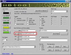

Option 2 - Edit your Bios and re-flash to start XBMC's default.xbe from XBMC Folder
This way is only recommended for experienced users. Changing your bios may cause your XBOX to not boot any more. First of all, if you haven't already done so use the guide to Installing XBMC as an App to get XBMC onto your Xbox. I will carry on with the E:\Apps\XBMC example but it could be any folder on any partition you want (except D: obviously). Edit your bios with XBTool (or EVTool if using an EvoX M8 bios.) to start XBMC's default.xbe instead of a xbe from C:\ on boot. Note you will not be able to use this method if you intend to persist with an X2 4983.xy bios as neither XBTool nor EVTool support it.
Circled in the picture is where you set your custom boot path for your bios (The diagram is for XBTool but EVTool is almost identical in interface and execution). Open a “standard” (supported) bios in XBTool (or EVTool for M8), use the up/down arrows by the drive letter to increase/decrease the drive letter by 1 and enter the path on the drive in the text-box provided. e.g. In the example- change drive to E:\ and enter "Apps\XBMC\default.xbe" (assuming you are keeping the name of the .xbe file "default.xbe")
Then save the bios with the edited boot-path (you can also edit the 2nd and 3rd boot sequences- they will only load if there is no .xbe file at the first path)- this is now where it starts to require some intelligence. First of all you will need to know what size of bios your mod-chip takes. e.g Some are 256k, some others take 512k- this is not a mod-chip manual you will need to find out this information for yourself or stick to Options 1 or 2. Suffice to say flashing your mod-chip with an incorrectly sized bios will render your mod-chip unless you have a multiple bank chip and/or an external programmer. Having a bootdisk in this situation will not help you!- the bios itself is corrupt so wouldn't even try to boot the boot disk

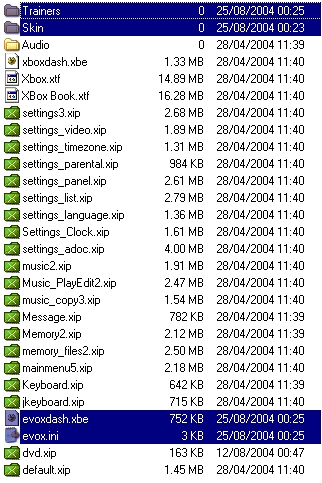

  • First of all FTP into your Xbox with your old dashboard.
  • When you enter the C: drive, it should look similar to the picture on the right. I have highlighted in blue the files that are related to your current dashboard (in this caseEvolution X). All the files & folders that aren't highlighted are required by the Microsoft dashboard and therefore shouldn't be touched- unless you know what you are doing.
Backup the non M$ Dash files to your PC.
  • Now would be a good time to create a bootdisk with these files (if you already haven't done so) which you can use if something goes wrong in the dash installation of XBMC (not that it should). Put the files you've backed up to your PC in a folder (lets call the folder Boot). Rename the .xbe file “default.xbe”. Now create an XDFS ISO of the “Boot” folder using something like Qwix,Craxtion or SimpleXiso. Now burn the created iso to a CD or DVD you know will boot up. If need be at this point before going any further, test the disc to make sure it boots on your Xbox. Make sure it does boot- if things go wrong this is your only way of getting ftp access to rectify any problems- so you need to make sure the disc boots.
  • You can see in this example that the only other .xbe other than xboxdash.xbe is labeled evoxdash.xbe, so it is safe to assume that you can rename the Shortcut XBE default.xbe to evoxdash.xbe and ftp it to the C: drive, and it should boot.
