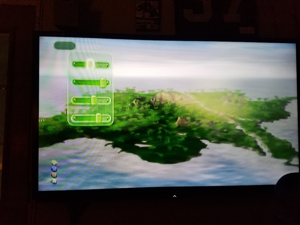

Some games will not display the in game menu captions/menu text.
I first though it was just a bad rip but after trying multiple different rips same issue.

The dashboard is displaying properly but the in game menu on a few games are lacking any text. I will attach a picture for clarity.

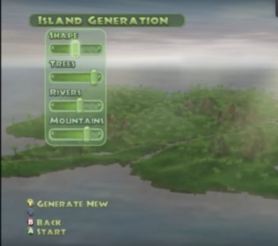

I found a youtube video of someone playing Jurassic Park Operation Genesis and took a screenshot of the menu with no issues Thanks again for any help and or suggestions

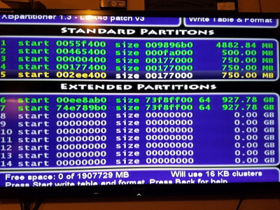

It worries me that you've said you have hundreds of games on the HDD and you're using a 2TB HDD. Please tell me that F:\ and G:\ were correctly formatted for equal space. They should both be exactly the same total size, <1GB. If you are not sure use XBPartioner v1.3 to check; just to check, do not reformat. If either show an E (Error) in regard to cluster size, which should be 64KB, you have a big problem.
Weird little errors can start occurring if you've used the wrong cluster size once the total size of the folders/files on that particular drive exceed 512GB if it was, for example, formatted to use 32KB clusters.

My 2TB HDD is separated into F: and G: drives that are both 927GB and 64kb Clusters.
I checked with XBPartioner v1.3 and it showed no Errors Im using FileZilla to FTP to my Xbox and I unzip it before FTPing.

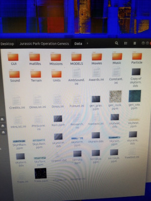

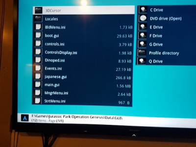

I think these .ini files within the GUI folder are the ones that control the menu display. Not sure why they are not displaying..

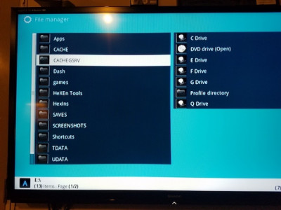

My E: drive looks a little low on space do you think that could affect the cache? Also I noticed that I have a second cache called CACHEGSRV I have tried multiple different downloads from different places and even downloaded a couple iso's

Obviously it is not a HDD formatting issue so that is very good news.

2). E:\ is a bit low. The recommendation is to leave 10% free but at least 100MB. You have more than that so should be OK.
Additional game files are usually written to the X, Y and Z drive which are not displayed in the XBMC file manager by default. Low E:\drive space and cache issues certainly cause problems but not, that I've read about, anything like this.
You could always try deleting or moving some stuff on E:\ to test that. If you have any games in "games" or apps that are taking up a lot of space on E:\ then those are the obvious things. HexIns needs to be left on the root of the E:\ drive as unfortunately it was written to be used just from there.
3). No idea what that CACHEGSRV is but unless it contains something clearly related to JPOG then I wouldn't worry about it. It is probably from an Emulator or Homebrew game some of which write stuff to the root of the E:\ drive no matter where they were installed.

I don't know why but when uncompressing on my Desktop running Ubuntu it occasionally would
give me the in game menu display issue or would make the games boot to black screen. I tried uncompressing the file(s) with my laptop
running windows and found the menu and game working perfectly. I have been testing the games to see
how many have this issue or boot to black screen and its about 1 in 20+ games. I have no idea why linux would have
issues uncompressing some files and no problem with others. I never received any errors when uncompressing any files.
Most of the files were .7z but I still had the same issue with .rar files when I kept trying multiple copies of Jurassic Park.
Thanks for the education on uncompressing files on XBMC or Unleashed. I made the mistake of FTPing a .7z file and trying to
uncompressing it.
