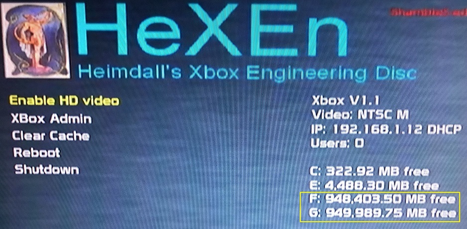

The only problem I can see with using Chimp is the F:\ drive formatting and that will depend on the size of the new HDD. The F:\ drive (and G:\ if used) must be correctly formatted if it is larger than 256GB. Cloning F:\ from the 70GB old HDD will mean that it is formatted for 16K clusters.
Later reformatting of the extended partition(s) for 32K or more, depending on the HDD size, will wipe the cloned F:\drive content, which is a bit of a problem.
So if that is the situation in this case I do not know if there is any way of using Chimp to clone the F:\drive but with the correct cluster size for the new larger HDD. Rocky5 will be able to explain if that is possible but you might be better off using the FTP route instead.
