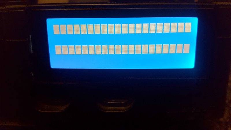

Hi,
Powered up my Xbox with X3 for the first time in a while. The LCD comes on but all pixels are on and it does not change.
I have tried the brightness in settings and contrast control on the X3 board, they adjust the display correctly and so that is not the problem.
I have removed and reconnected all cables and the X3 board itself but no change.
Does anyone have any suggestions I can try?
Cheers, Ant.

I have had that happen it might be because the lcd is out of line with the pcb because of a knock or drop ?
I re aligned the lcd and it fixed mine.
