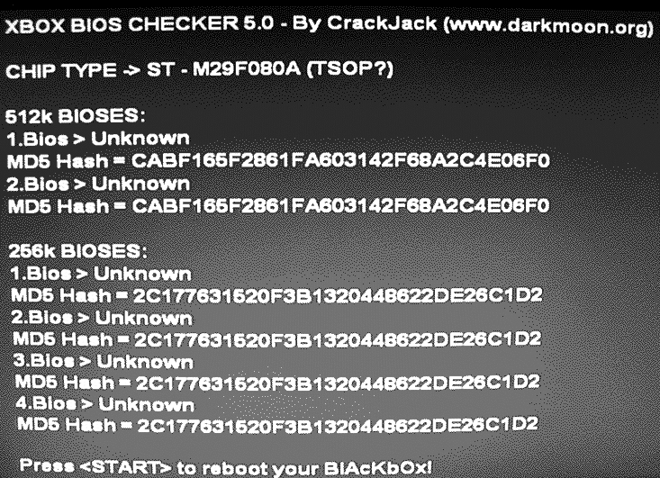

Hi guys.
I'm trying to remove the flubber animation at start-up.
I'm not familiar with the inner workings of the console.
Some facts:
The console is modded (don't know what chip) and has a 50Gb hd running XBMC as default dash.
• console version: 1.4;
• the "open" button starts the M$ dashboard;
• the "on/off" button starts XECUTER 2;
I took a screenshot of Bios Checker (and is attached in this post).
Question:
Is there a way to remove this animation, detect what chip I have monted only using an ftp access to the console.
And not by:
• burning any DVD/CD (don't have a burner);
• gamesaves ..like 007 (can't get an original game);
• openin the console (don't have the screwdriver).
Thanks.

Re: Remove animation
You wont be able to find out what the chip actually is unless you open the xbox or are very familiar with chips, you might be able to look on the left side of the case through the vents and maybe get a peak at what it is. If there is a little LED on the chip that would help, if you see a flashing red LED it's probably a DUOX2. Also, you can potentially see what bios is being used through XBMC, navigate to system info page and then under general or hardware i believe it tells you the current BIOS or kernel that is being used. Since we know it's an X2 bios you should look for something like X2_4981 or X2_5035 and that will tell you what bios you have.
To get rid of the flubber will depend on the bios too, with X2_5035 you can edit a text file stored in E and that will take the flubber away, i suggest using a program called X2_Config Maker which can be found very easily with a quick google search. If you have an X2 bios that is not 5035, something like 4981, you will need to use a program called XBtool to edit the bios and then reflash it to the xbox, not something your equipped to do I dont think. I would encourage you to get a screw driver and some torx bits to crack open the xbox and have a peak at what you've got. Hell you might not even have a chip, it's a 1.4 xbox and someone could have flashed the TSOP chip with a hacked bios.
I'm not sure but I think you need to add a file of BIOS hashes somewhere for this to work? When I've looked at this its said unknown(or something similar).Nextelhalo wrote: you can potentially see what bios is being used through XBMC, navigate to system info page and then under general or hardware i believe it tells you the current BIOS or kernel that is being used.
There is a function mod chip lookup you enable in the advanced xml but it is disabled by default as it causes specific chips to crash the xbox, i believe it can detect the chip type.
the modchip info would then show in the system info tab.
it is aimed at detecting the gen 4 and 5 chips from memory that have advanced features.
Of note: Xman made a small package of a modified slayers installer with flubberless bioses in it that you copy on yourxbox and flash it, problem it wont work with windbond chips which it looks like you dont have so not a problem.

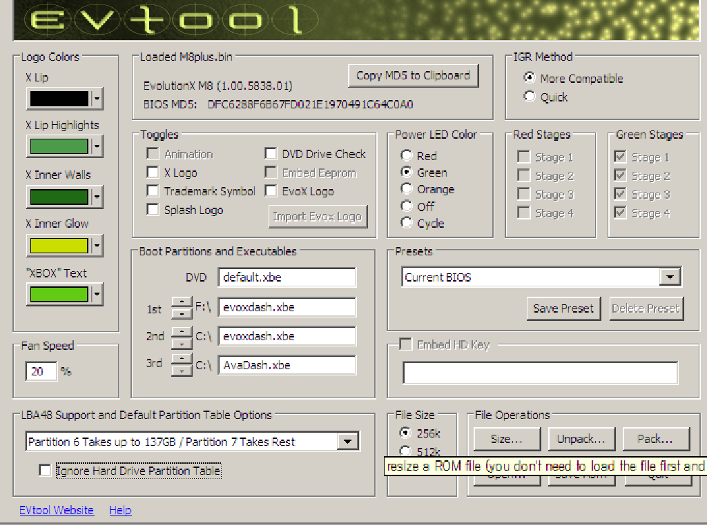

Some other stuff that might help:
The guy that did the mod had written (in very bad calligraphy) this note under the console:
· Mod DUOX 2 (or DVDX 2)
· DVD Philips
· HD WD > MAXTOR
· XCutter 24985-67 Philips
Plus another thing:
I found a file "bios.bin" (1Mb size) in the folder /E/UDATA/ffff05ae (seems to be a folder of BiosChecker)
I opened the file with XBTools and from what I remember it says 4981 somewhere.. And seems to be the bios that loads by default because the colors of the X logo inXBTools, matched the ones the console uses at start-up.
I unchecked the "animation" box saved the bios.bin wich now is only 256Kb.
The only thing is I don't know how/if I can load this new version.
Thanks for the help guys.
You can try it with out flashing it if you save it as a bfm bios using xbtool and load it with pheonix bios loader to try it.
as the duo x2 has two banks you could switch banks with the switch on the side and flash the other bank to try it if that is infact what you have.
as you dont have a dvd burner there is an alternative way you can do it and it is how i do all my slim's with out dvd drives:
get a copy of slayers or evox create a directory on your xbox somewhere and make a file called evox.ini with the following in it:
then copy the files in the root of the slayers cd or the evolutionx files on to the folder you created on your xbox you dont need to worry about sub directorys except the skin directory and the only skin you need in there is the SlaYer26 one.
Then create a directory in the folder called system and drop a bios of your choice in the folder name it to:
"evoxm816.bin" if it is a 1.6 bios
or
"evoxm8.bin" if it is a 1.0-1.5 bios
Then just load it up the program inyour file browser from xbmc and flash it using the on screen prompts.
It shuld handle the rest for you.
This is the sample path and instructionfor it to flash the bios files you could change it if you like it is near the bottom of the ini file if you wish to modify the installer to point to another location of the bios you select:
you could also change this section to make it say another bios or onscreen prompt to say flash x2 bios with no flubber:
i would upload it for you for you but i dont have broadband sorry.
one thing i would reccomend getting a "clean" bios from the hexen dvd or somewhere else as you dont know what that bios is it would be safer to mod one you know it will work then and is correct for your motherboard.
I have the boot order this way (attached image)
I opened a bios file I had on the xbox hd and I put the same options to the M8 bios (just without animation)
I also changed the option "LBA 48..." I hope I did nothing wrong.
The console starts ok though.
TBH I don't really know much about the hard drive options, I only use a small hard drives so I just leave it alonesomeone wrote: I also changed the option "LBA 48..." I hope I did nothing wrong.
As long as it all work thats what matters. Although your boot paths are a bit odd. Do you have xbmc renamed to evoxdash.xbe?
