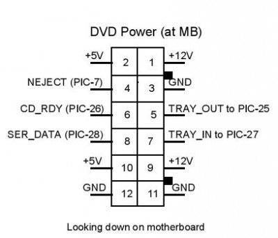

But, they've also posted another link to a discussion where the mod didn't work. Have not read all of this new thread yet. So still ???'s about the proper method to remove DVD and still allow stock Xbox to run without Error 12? screen.
Although, Harshboy and Rocky5 mention different pins to be tied together. Not sure which is correct as I've not tried this mod.
Voltage levels for a v1.0-v1.5 and v1.6 Xbox may be different. Xcalibur incorporates the SMC functions found on older versions using a PIC processor. Xcalibur's power/eject signals are 3.3V not 5V. Follows that the control lines that run from the DVD drive to the SMC use the same logic levels as the front panel buttons Best measure the voltage levels for the tray_in, cd_rdy. If 3.3V a voltage divider needs to be made or find a source of 3.3Vdc. If 5Vdc, the voltage is available on the motherboard DVD header.
But this figure has to be WRONG as the motherboard connector has 14 pins not 12. There should be 2 more pins, continue on with 13 and 14, which actually have no connection. On the DVD drive side, there are only 12 pins.

It’s not wrong the diagram is 109% correct. But don’t do the above, I blew two Xbox Ethernet controller chips doing this and will never do it again. My poor 1GHz board
It doesn’t work how you think anyways, it still requires a bios with the no dvd Hack. All it was meant to do was stop XBMC or other dashboards from thinking the drive was open.
You can find the thread on here that trusty made with how it turned out for me.
I fixed trusty’s diagram and showed the proper way but the image was on imageshack and they removed it when they went subscriber only. Supply 3.3v not 5v or you will get a pop or the Ethernet controller chip will just die.
Here is how to do it correctly. I have no clue how trusty never damaged his board or maybe he did and never new?
