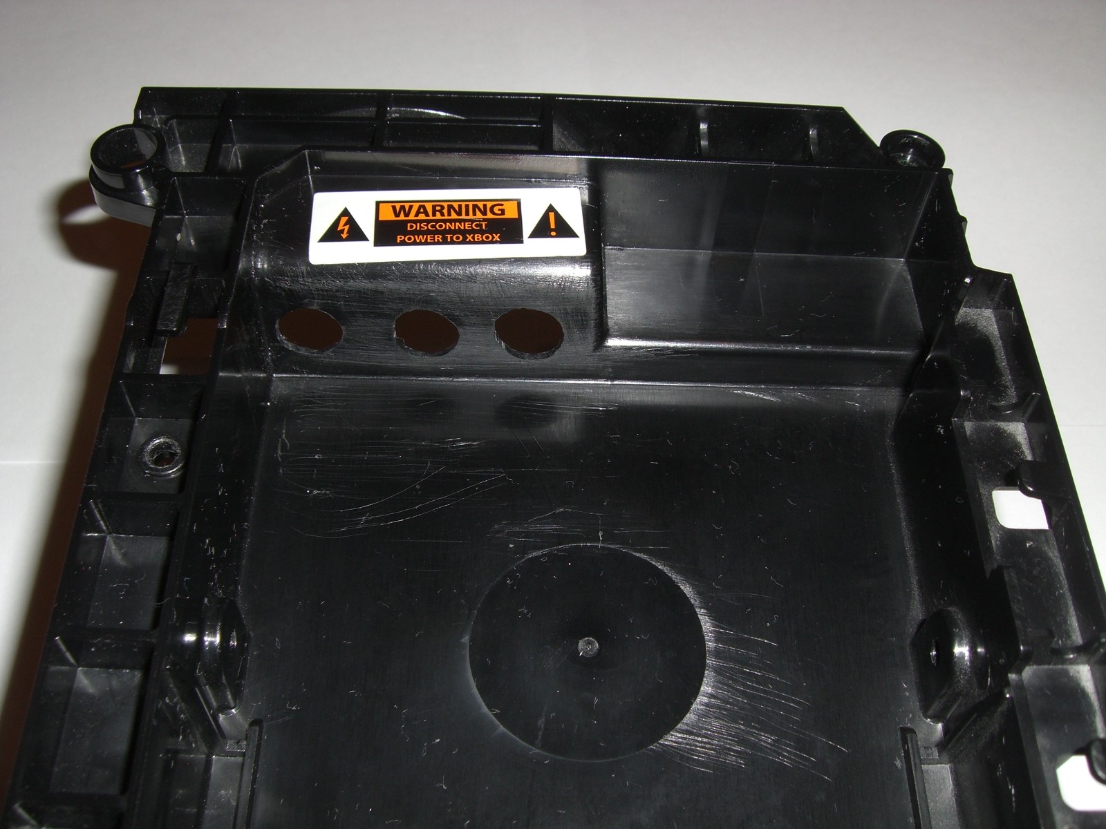

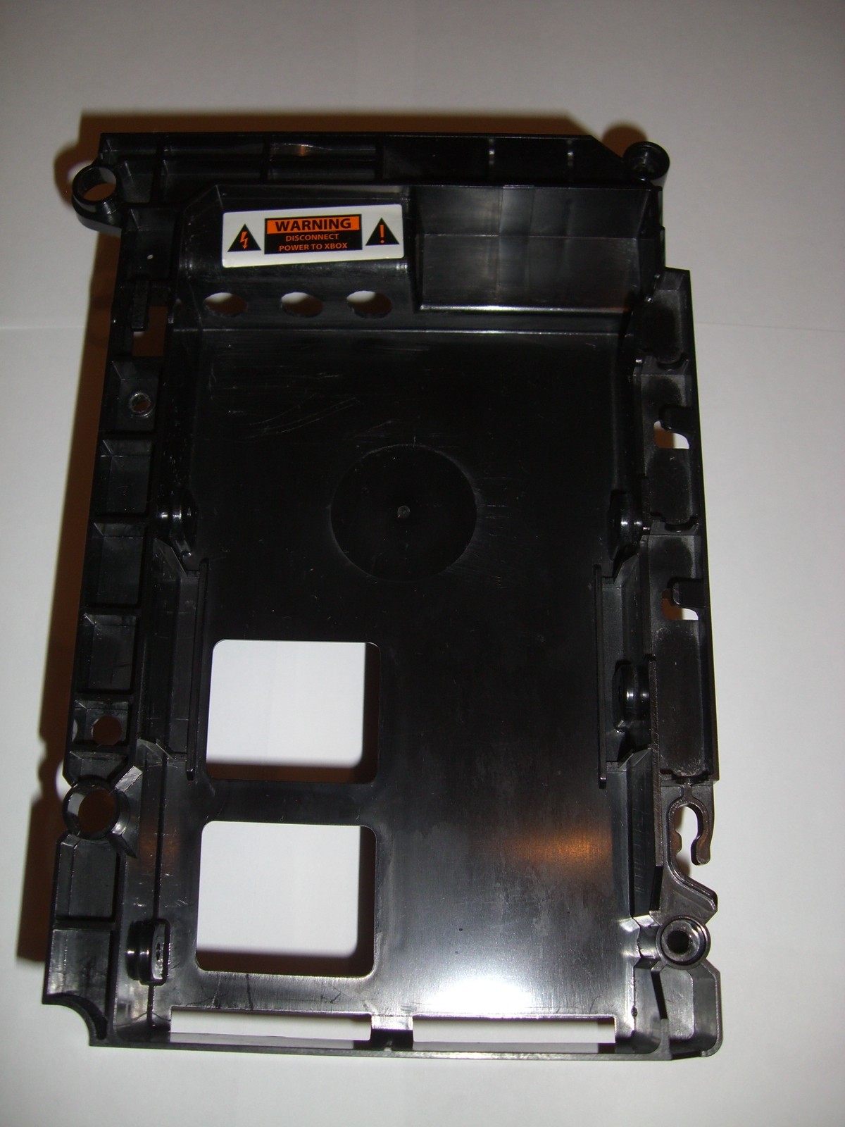

Re: What does make the temperature rise?
I tried it without the HDD case and indeed not really a difference.
But the room is very warm at the moment. So cannot really say.
I just drilled 3 holes in the HDD case. See pictures.
After playing some videos the CPU temperature went to 51C-52C.
But again the room is warm at the moment.
Hope these holes are enought for me.
Otherwise I might have to drill also some holes where the Warning sticker is.
By the way this is my first hardmod on the xbox
