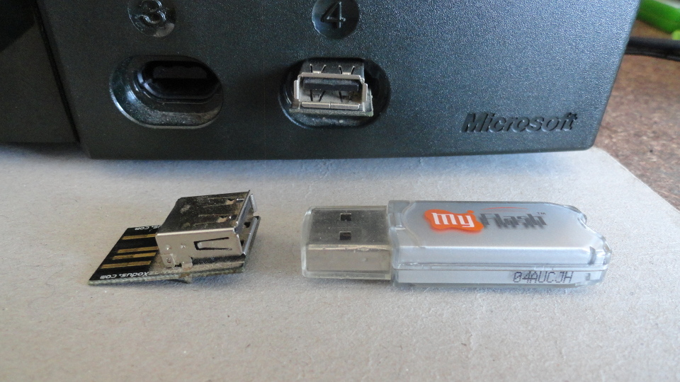

Firstly I probably wouldn't rely on using USB sticks as you will probably have issues with compatibility.
I remember having this difficulty over ten years ago (2005), when even then the USB sticks were too new.
I have an old 256mb stick which was the only compatible USB stick I ever come across and I still have it.
But on the other hand I could be wrong I havnt tried a new stick from more recent times....
I faintly remember that some people found that an micro SD card in a USB adaptor did the trick..
Alternatively I would suggest installing via DVD installer but don't think this is an option for you atm...
Or even easier FTP it across once the console has been softmodded with the exploit...
You only really need the exploits on the memory card...
I really would avoid destroying a memory card, I know that in Australia they are very hard to come by and expensive.
There are cheap chinese "usb to xbox" cables on eBay for only a couple of dollars...
I got these with my Xenium's years ago...

I know about the cheap cables, and they would be easy to make. The reason i want to do ut the hard way, si that its an project for me. I work on a fish farm, and live on a barge at sea every second week. I am getting really tired of surfing the web and watching tv, so projects are very welcome to make the evenings pass. I actually started modding the memory card, before i read this, but i havent destroyed it yet. I will make a post about it, and you can see the reason there. But because of this, i decided to make a cable for now and maybe do the memory card mod later (If not i decide to keep it, we'll see).
I have about 20 different usb sticks to try, from old ones to new ones. Hopefully i will find one that works, but if not i may try using the memory card so i can finally softmod an xbox (Have several softmodded xboxes, but they where done ages ago and by my brother in law. It's time for me to do one myself) But then there's the question. How to get a savegame on to the memory card if thats what i need to do. Can i just connect it to the computer via the controller and usb? I have a controller port to USB cable i made years ago, to use the xbox controller on a pc.
