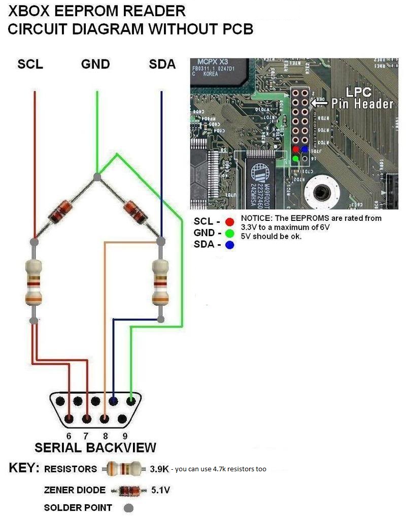

Try building an EEPROM reader,read the EEPROM then build a new HDD using XboxHDM. Also,FYI,E13 will NOT unlock the HDD. E11 and 12 will. ;)
Here's quite why:
E13 - no dash found - this is generally sign of a really botched softmod disk. HDD will not unlock on this error.
E11 and E12 - no DVD-ROM drive found - this is because either the power cable (usually coloured yellow) or the IDE cable going to it is removed - you want to get this error in order to unlock the HDD.
As for softmodding - again, it's better if you build a EEPROM reader (see pic),read the EEPROM (use Ponyprog,then save the file as eeprom.bin - just google how to do that,there's tons of guides how to extract your EEPROM) and then add it to your XboxHDM disc,inside the EEPROM folder,then build the iso. You will need a PC that has 2 IDE ports,and have the HDD you are building set as primary master.

EvoluterX wrote:E13 - no dash found - this is generally sign of a really botched softmod disk. HDD will not unlock on this error.
The HDD is unlocked at this stage, i.e. It unlocked the HDD and couldn't find the xboxdash.xbe located on the C partition.
I'm assuming any error that isn't directly related to the kernel, ram or eeprom will have the HDD unlocked when displayed.
( as the kernel, ram and eeprom all happen before any other extra hardware initialisation )
I have hotswapped from error 13, error 16 I have never had to disconnect DVD cables.
( you have about 2 to 3 seconds to get the PC side IDE or IDE adaptor plugged in )
Also to the OP, sounds like the hdd is on its way out, you will need to do above ( what EvoluterX said ) to get the eeprom so you can lock a new drive to the Motherboard, install a chip or get it softmodded some how to get the eeprom.bin.
