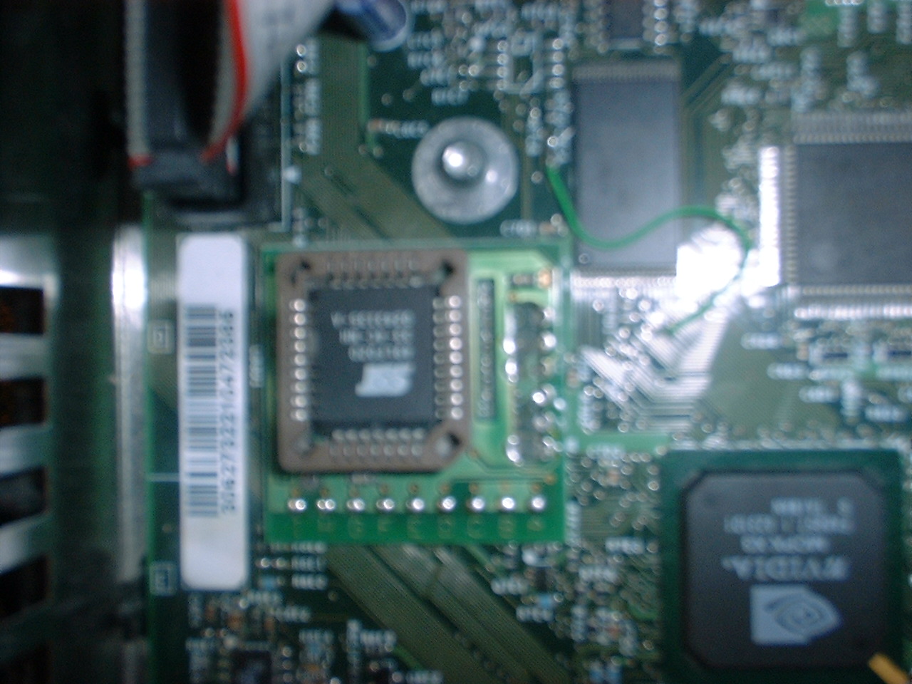

Hi, can anyone tell me what modchip this is? It`s flashable, only tried a 256 BIOSes atm. X2, IND and Evox all seem to work.
It`s not on a pinheader it is soldered directly to the mobo (v1.1), and has a single green wire link.
Sorry that the photo is a bit out of focus :(

Kinda looks (and sounds) like an old Aladin chip but i couldnt find it on the list at X-scene. Hope someone can answer this, i'm interested to know.

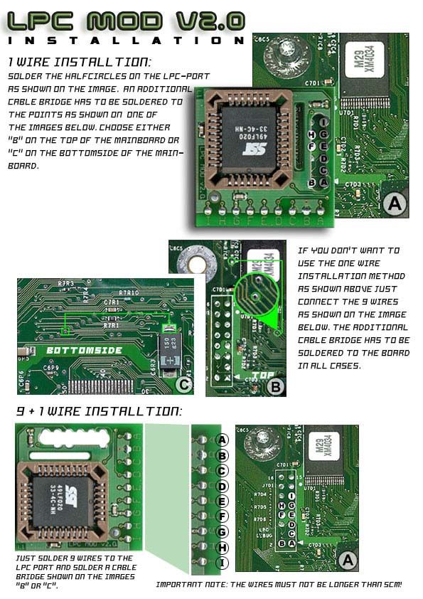

Nope. It's an old cheapmod :)
http://www.llamma.com/xbox/Mods/cheapmod_assembly.htm
It works only on 1.0-1.2 consoles I think.
I have similar one in my collection :)

Thanks Xphazer :D Just need to find out if its a 256k or higher now?
Done a bit of Googling, looks like it's 256k?
Re: What modchip is this?
256 ;)

Since it's just a 256kb chip, you might want to consider flashing the TSOP since your console has a 1mb TSOP.

problem is that chip will only work on a 1.2 to 1.0 cheap mods were patched out with the advent of the 1.3 motherboards because of an adressing issue implemented to bar them.
it has limited use.
