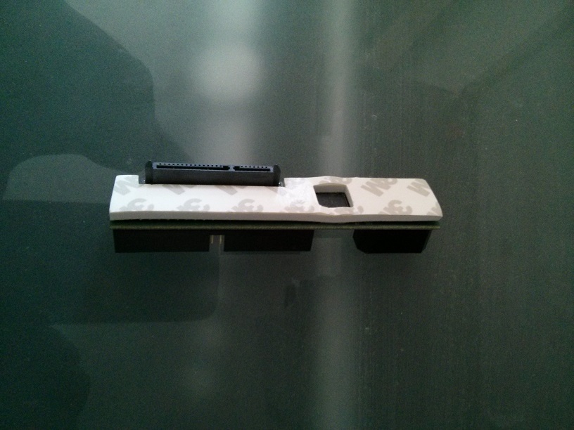

Re: SATA adapter burning out
This is the most recent adapter that burned. Shorting out against the drive definitely did not happen with the 3M foam tape in place specifically to prevent any chance of shorting out.

The pins on the solder side of the adapter will piece straight through that. I would be using hard plastic if you think spacing is required.Skaught wrote:This is the most recent adapter that burned. Shorting out against the drive definitely did not happen with the 3M foam tape in place specifically to prevent any chance of shorting out.
I doubt it very much, most adhesives do conduct electricity. Electrical tape is one of the only ones that is guaranteed not to. If the sticky side of the tape is stuck directly to the solderside of the adapter, I'm pretty sure it would short out without the HDD connected. I personally would use multiple layers of electrical tape. I don't know how good your adapters are made but all mine I clip the high solder joints so there are no tall, sharp pins that could punch through the tape.fxmech wrote:Is that ESD safe tape? I just used electrical tape...
