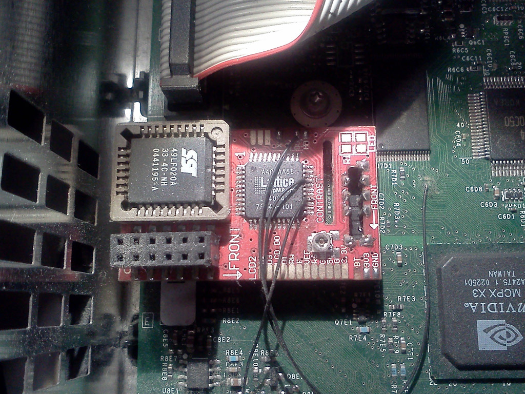

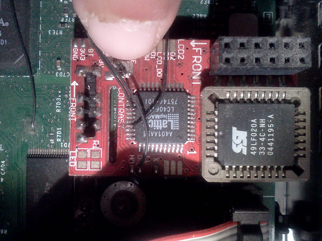

Well, i've opened it but didn't find any switch or anything look like that. I took some pictures
Will also try EurAsia Pro Generic Flash Disc v1.3 since here http://www.eurasia.nu/modules.php?op=mo ... topic=2816 there's someone who did it even with that error.
Should I give up?
Should I give up?

Re: Update BIOS on modded Xbox
You have standard SST49LF020A flash, so problem isn't here.
I can see that you have 1.0/1.1 Xbox. I suggest to flash TSOP with proper BIOS
Anyway, where goes these 2 wires from Lattice?
Well I see the problem straight away. That's an LCD version and needs to be swapped with me for a standard Aladdin XT.
I'd swap 3 XTs for that chip. Been hunting everywhere for one of those. Not after a clock face are you?.
