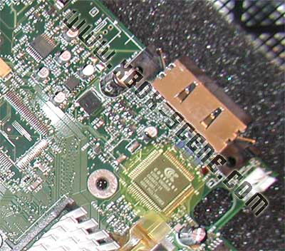

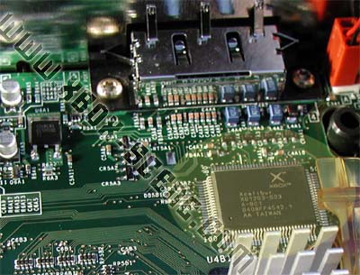

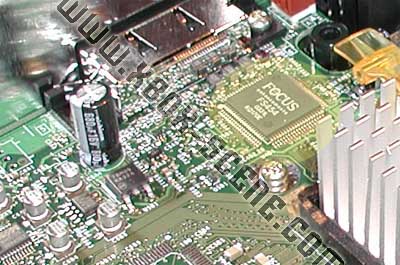

After taking apart the machine and removing the HDD caddy and DVD drive caddy, look at the mother board just in front of the video/ audio connector for the video chip. This will tell you what you have.
VERSION 1 TO 3 [Conexant].jpg (37.36 KiB) Viewed 1247 times
VERSION 4 OR 5 {Focus}.jpg (30.12 KiB) Viewed 1247 times
VERSION 6.jpg (33.32 KiB) Viewed 1247 times
