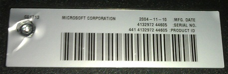

I got really lucky with CraigsList and picked me up 4 Xbox's this weekend, and one was from a European lady, and even had the euro power cord with adapter.
I uploaded a pic of the serial number, what can you guys tell me about it?
I have not installed the Splinter Cell exploit yet (time) and I haven't delved into TSOP yet.
Wondering if I would/might run into any road blocks with modding this?
Thanks guys

see this http://web.archive.org/web/200903050651 ... ions_HOWTO
I think that's a 1.6

Good link, yea it does appear to be in the unconfirmed but likely 1.6 territory.asbo wrote:see this http://web.archive.org/web/200903050651 ... ions_HOWTO
So that's the last model of Xbox, will there be any limitations? I think I remember reading there isn't a TSOP for the 1.6 right?

No tsop, and no 128mb ram mod, according to trustypythonjosh wrote:Good link, yea it does appear to be in the unconfirmed but likely 1.6 territory.asbo wrote:see this http://web.archive.org/web/200903050651 ... ions_HOWTO

Probably a v1.6 looking a the date. But, since it's already been opened why don't you open it and have a look at the video chip - if it says Xcalibur on it,it's a v1.6.pythonjosh wrote:I got really lucky with CraigsList and picked me up 4 Xbox's this weekend, and one was from a European lady, and even had the euro power cord with adapter.
...and it's probably been opened up for a reason. Have a good look around; modchip? different hard disc?

Correct, 1.6 boards lack the locations for the extra ram chips.GhostlyGamer wrote:No tsop, and no 128mb ram mod, according to trustypythonjosh wrote:Good link, yea it does appear to be in the unconfirmed but likely 1.6 territory.asbo wrote:see this http://web.archive.org/web/200903050651 ... ions_HOWTO

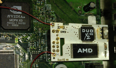

Ok so I got to turning on the European one, right after the green plasma splash, i see a team Xecuter 3 logo!
So I shut it off and crack it open and here's what I found. A Duo X2. Now I don't know much about these mod chips, what did I just get myself into?
Oh and I got this with the HD modules, all for $40

The duox 2 is a pretty good chip, it has 2 banks,512kb each, and a switch on the chip. Shame you hat you got your hopes up for an x3 though.

it looks like theres a bit of flux damage on the duox2pythonjosh wrote:Yea you shoulda seen the look on my face when i saw that X3 icon, and then the look on my face when I saw the DuoX2.
It was kinda like that kid that got a sweater in an Xbox360 box for christmas.
but as far as i know, you werent supposed to put a x3 bios on anything but an x3 chip...

Any X3 logo has to be some kind of mod to another bios because X3 bioses only work on X3 chips and even if they worked on non-X3 chips, the X3 bios is 1mb, so it can't fit on a 512kb bank.
