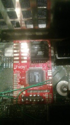

Whilst in there however I found a red modchip in the same place as others I have seen , after googling ,it might be an aladdin I think .

You can always softmod it at any time, take a picture of the chip as it sits and post it up. Xman is the Alladin king and I bet he can help alot just from the picture.

It's an Aladdin XT (XenoChip) 4032/4064
http://www.xbox-scene.com/modchips3b_table.htm
HeXEn can't fix how it boots - that will require some soldering to permanently enable the chip.
You might not need to reflash the chip. Run Evox or XBMC or BiosChecker, see which BIOS they say the Xbox is running. If that doesn't work, try running XBPartitioner 1.1 or later, see if it complains about LBA448 support.
