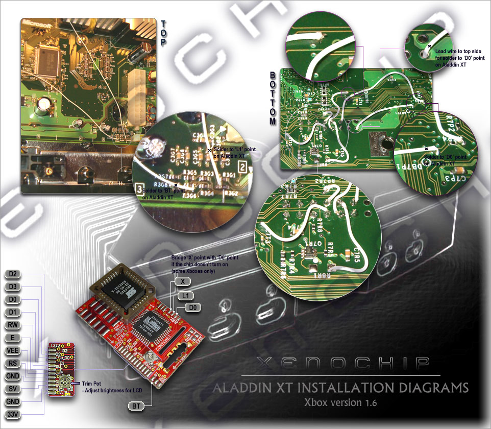

Aladdin XT-
I have other data regarding the other Aladdin types if required but this XT is very similar as the latest ones still available. They have a single 256k bios as all Aladdins do and it doesn't require the dedicated bios flashing tool early Aladdins did require to flash. You may need to add the bios chip numbers to your disc, Slayer's etc, so it recognizes the bios chip type to allow you to flash.

also on the aladin xt plus some are fitted with a sst49lf0002a flash chips and need a jumper switched to enable flash write it took me ages to find this ill put up a pic when i get around to it.

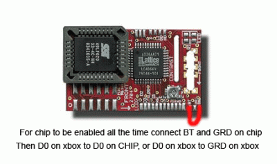

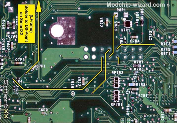

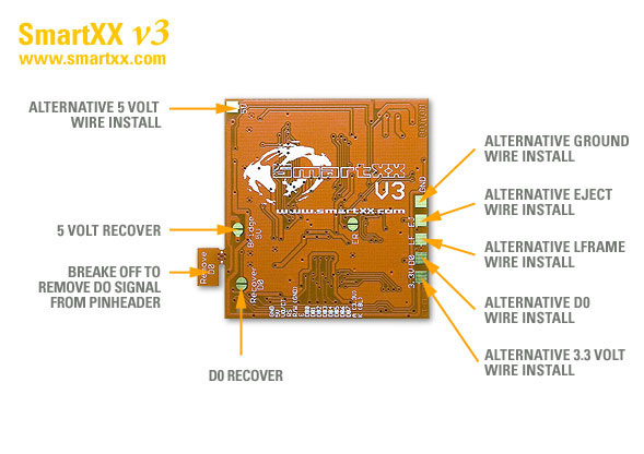

Any modchip install needs a wire from the modchip "D0" point to the "D0" point on the motherboard. This is the D0 point on the underside of the mother board. The LED points for the LAN activity and Hard Drive activity are also shown should you like to hook up these LEDs-

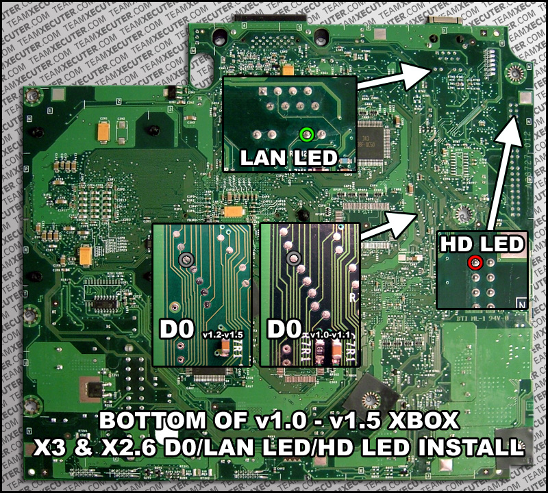

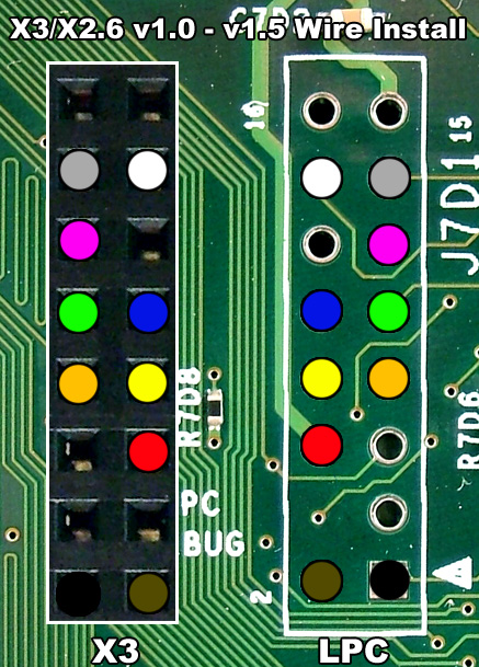

X2.6/X3/CE Pinheader install (V1.0-1.6) (Updated pictures and better explinations) http://team-xecuter.com/x3ce.pdf

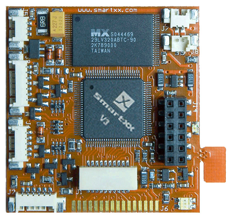

A SmartXX Version 3 which I have for an Aladdin 4064 which you have. I'm presuming your Aladdin 4064 is the LCD version with the trim pot on it with the pinouts for driving the LCD, yes?. Well if it we may be able to do some kind of a deal but you must take into consideration the purchase price of that Aladdin when it was new and the price this SmartXX was not that I paid for it, I swapped an X3 for it to a member that needed only an X3 for his install but still that X3 did cost much cash. Anyway, let me know what you think is fair if your interested.
