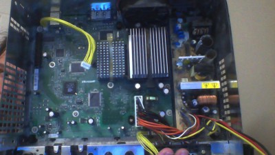

I'm a newb that picked up a used xbox for like $20 at a second hand store. I've just started an electrical engineering technology program in college and have a little background in ham, I have my advanced certification in Canada.
I've identified my version as a version 1.6 - made in china after 2004 (like in 2005) pretty much assuring it is a version 1.6, has the toshiba-samsung cd rom and the seagate harddrive
picture attached
think it is version 1.6
I'd like to get something like evolution x on it. I have read this is possible with softmodding. I'm also wondering if there is anything that can emulate a dvd drive, ex replace the dvd drive with another device that reads as a virtual dvd drive.

Softmod is the easiest, with Splinter Cell (or MechAssault or 007:Agent Under Fire, but not all issues of the games are exploitable).
On a 1.6 the only alternative is to fit a chip.
There are no DVD drive emulators that I am aware of. Why do you want one? Once the Xbox is modded you can install a larger hard drive, and run all of your games from the hard drive, if that's what you mean.
