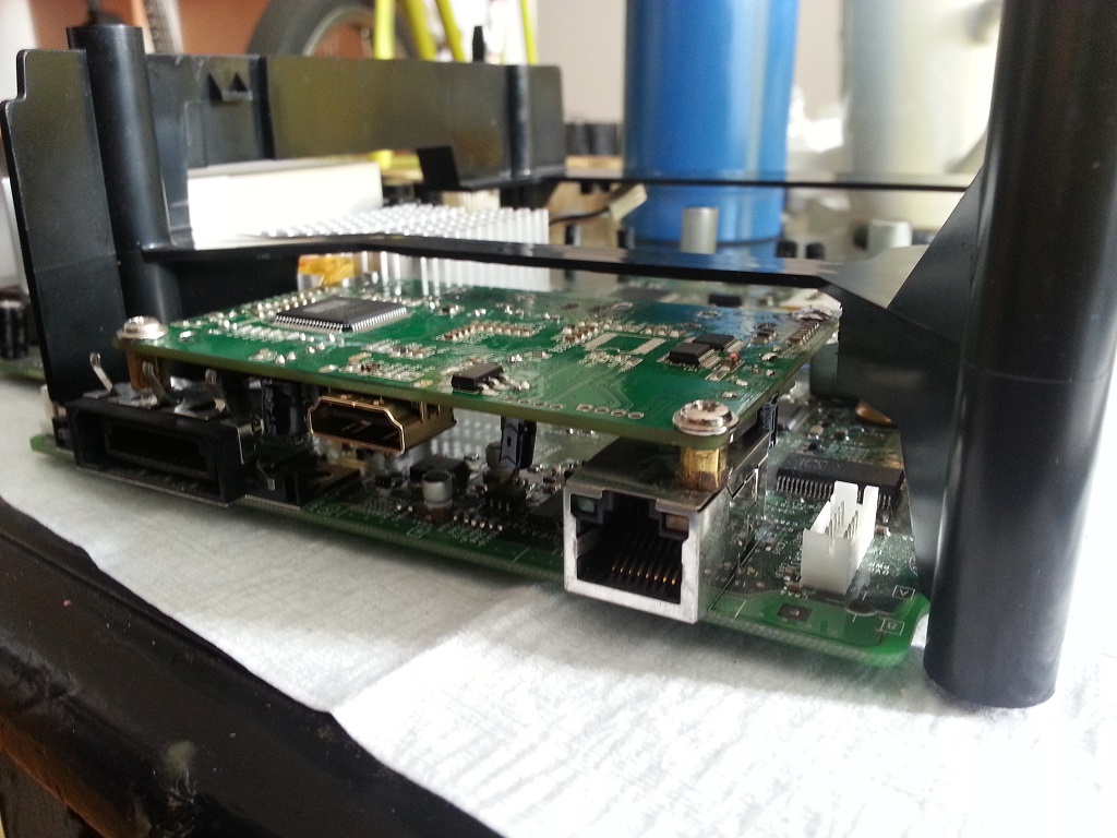

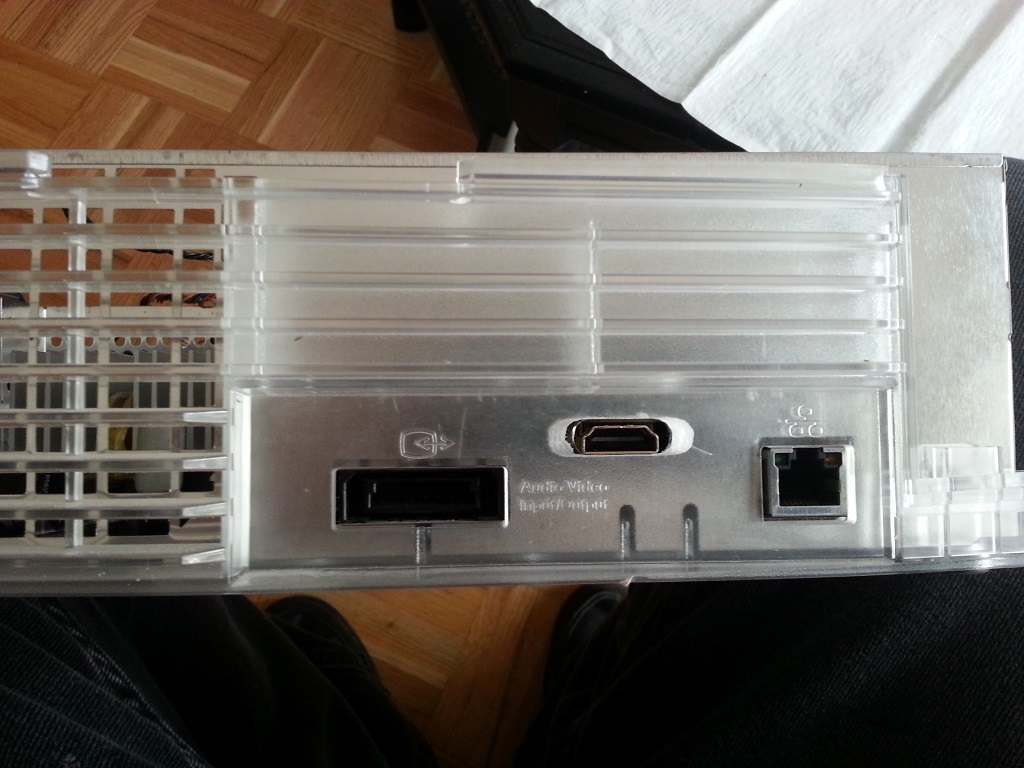

Hey!
I've added HDMI out to my XBOX!
Here is some sneak previews:
I have enough pictures to write a tutorial for this... If anyone is interested... :mrgreen:
Just waiting on attachment permissions!
Cheers for now..

wrecklessk wrote:I've added HDMI out to my XBOX!
Incredibly neat work. Yes please.

I don't want to sound like the party breaker... But this is not a native HDMI port... This is an internal Componant to HDMI adapter.
This would be important to mention it as its completely different.

Xphazer wrote:I don't want to sound like the party breaker... But this is not a native HDMI port... This is an internal Componant to HDMI adapter.
This is true. But it saves the hassle of having the adapter external, as well as having to power it externally as well. It still operates in 1080i, 720p etc no problem.
The adapter is powered directly off of the switched 5v on the motherboard so it turns on and off with the Xbox power switch. Its also set up so that if you have to remove the motherboard, everything comes out in one piece without having to desolder much (just the video mode switch on the back would have to be desoldered... 4 tiny wires, no big deal)
M.

Looking at the top pic it looks like you've added some pretty beefy caps in there haha :-D

nayparm wrote:Hey nice one mate, you beat me to it. Very nice install. Which converter did you get? I still have a bid on one that ends tomorrow.
What is the quality like compared to straight component?
I actually find that the color quality is a bit better when using emulators.
It works beautifully :)
I'm not sure of the converter brand, but the size and shape of it made mounting it to the motherboard a snap! (I used brass stand offs soldered to the metal shielding over the Ethernet and A/V ports)

nayparm wrote:Looking at the top pic it looks like you've added some pretty beefy caps in there haha :-D
I thought the same thing :D

Xphazer's point is well worth stating - for anyone coming fresh to the original XB0X, they might have thought this mod was exposing HDMI straight off the Xcalibur/Focus/Conexant video chip - which of course it is not. There is no native HDMI support, it is taking component output and converting to HDMI for ease of connection to modern tellies without the additional cost of, increasingly difficult to find, XB0X component cables.

wrecklessk wrote:I'm not sure of the converter brand
I'd suggest that's probably the most important detail - the make and part number of a converter that is the right shape and size and with the connectors in the right places to allow it to fit neatly inside an Xbox case.
When I first dug around in the forums, I came across this post which mentions the exact converter that I used.
http://www.xbmc4xbox.org.uk/forum/viewt ... HDMI#p8448
But I'm sure that any converter of similar size would work. It would just require a bit of imagination to fix it in place. In fact, the converters that have digital audio (which I wish I would have used...) are actually a good bit smaller than this converter.

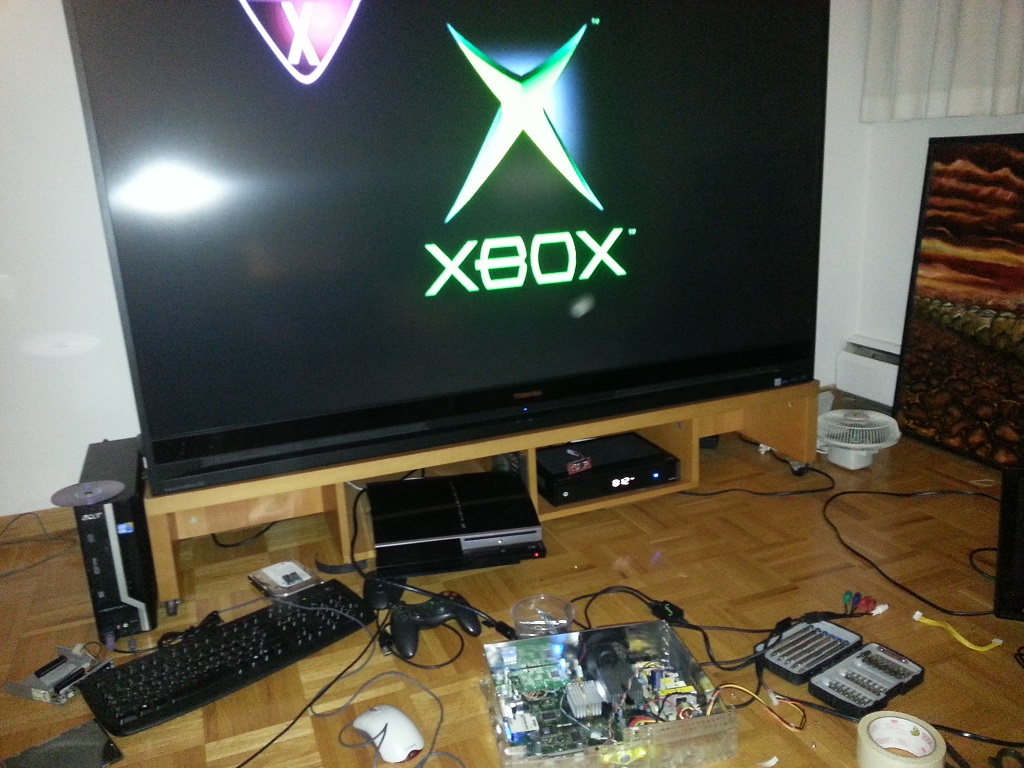

I was well aware this was not an Xbox hack to get HDMI out of the board and was an adapter mounted inside the machine, one look at the pictures confirms this point, however I believe it is important to see how Wrecklessk did his install and what part he used stems from the fact that I know the manufacturers of the current generation T.V.s are now phasing out composite, component and DSub connectors from there T.V.s and are supplying T.V.s only with HDMI connectors. We have found this out in the Arcades as we buy many new T.V.s a month because of damage, breakage etc and are having a hard time sourcing T.V.s with anything but HDMI connectors on them, (new arcade games use HDMI but our older games need a DSub connector). We are currently testing a collection of DSub to HDMI convertors so as to keep our older arcade games alive. There are heaps of Component to HDMI convertors available but to find one that you know will fit inside the Xbox case and is said to provide a nice conversion is what really prompted me to ask for a nice pictorial. ;)
Re: HDMI Out for original XBOX
xman wrote:...a nice pictorial. ;)
I really love the workshop - sixty inch plasma on castors, and an XB0X in bits on the beautifully polished parquet flooring. Great stuff - the way it should be.
