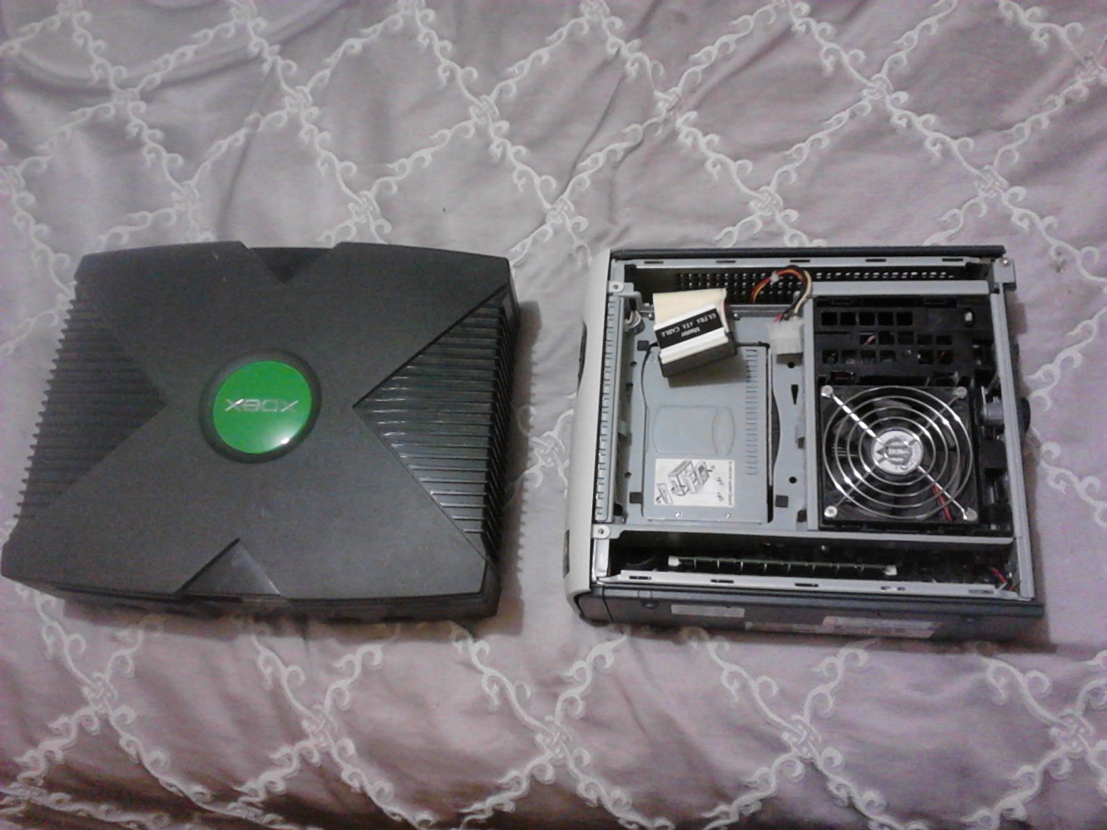

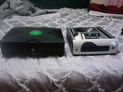

Side by side you see that the pc will easily fit inside the xbox case , may even be able to squeeze the psu in as well.
Looks can be deceiving as they say , mobo is just a bit too long to fit in the case without majorly butchering it.
It will fit sideways but then that will place all the I/O ports on one side which is not ideal and i dont want to stuff around re wiring them to locate them at the rear - will have to look for either a mini/micro ATX or a SFF that will fit.
