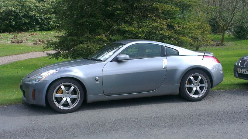

Mine.
Re: Show us Your Daily Driver.
Very nice Bombshell, always like the 350's and the 370's.

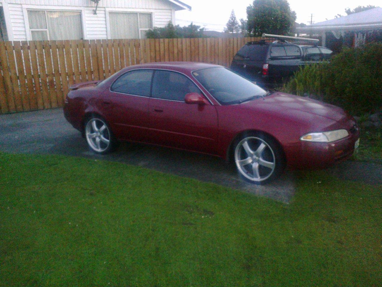

here is my car it is a bit of a work in progress and has been for some time.
it is a toyota sprinter marino 1992
it has a 4age 20valve motor with after market cams hbeam rods pistons and a ballanced and knife edged crank with the oil gallerys plugged and cross drilled.

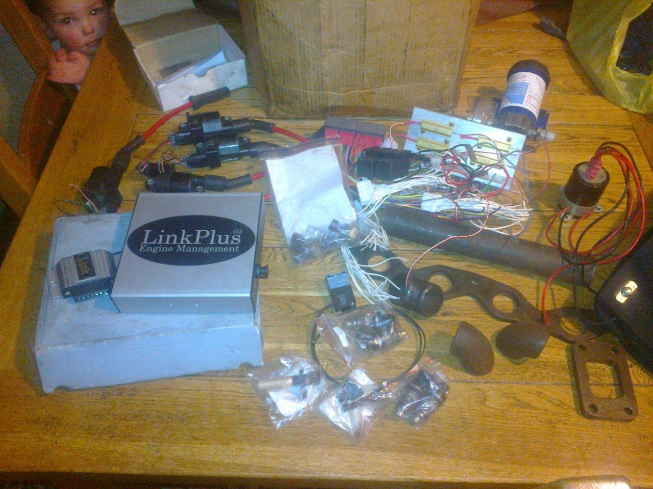

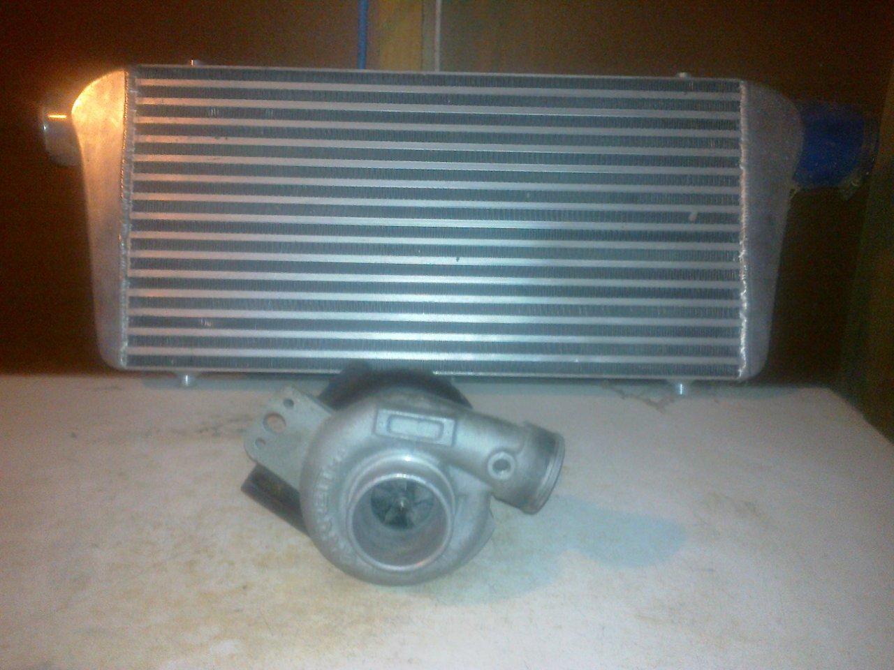

i have a garret 28g turbo to go on it with a big ass intercooler, wideband 02 controller, link+ g3 engine managment computer running 5 bar map sensor and it also has a nitrometh water injection pump and spray nozzles as im running 13.5 :1 compression and intend to run 14psi which will produce some serious power and be very streetable.
i have quad injector packs with built in ignitors as i had to go this way to get the revs to go beyond 10k and i had to provide a large capicator to drive the powersupply for the ignitors to aviod fade at high rpm.

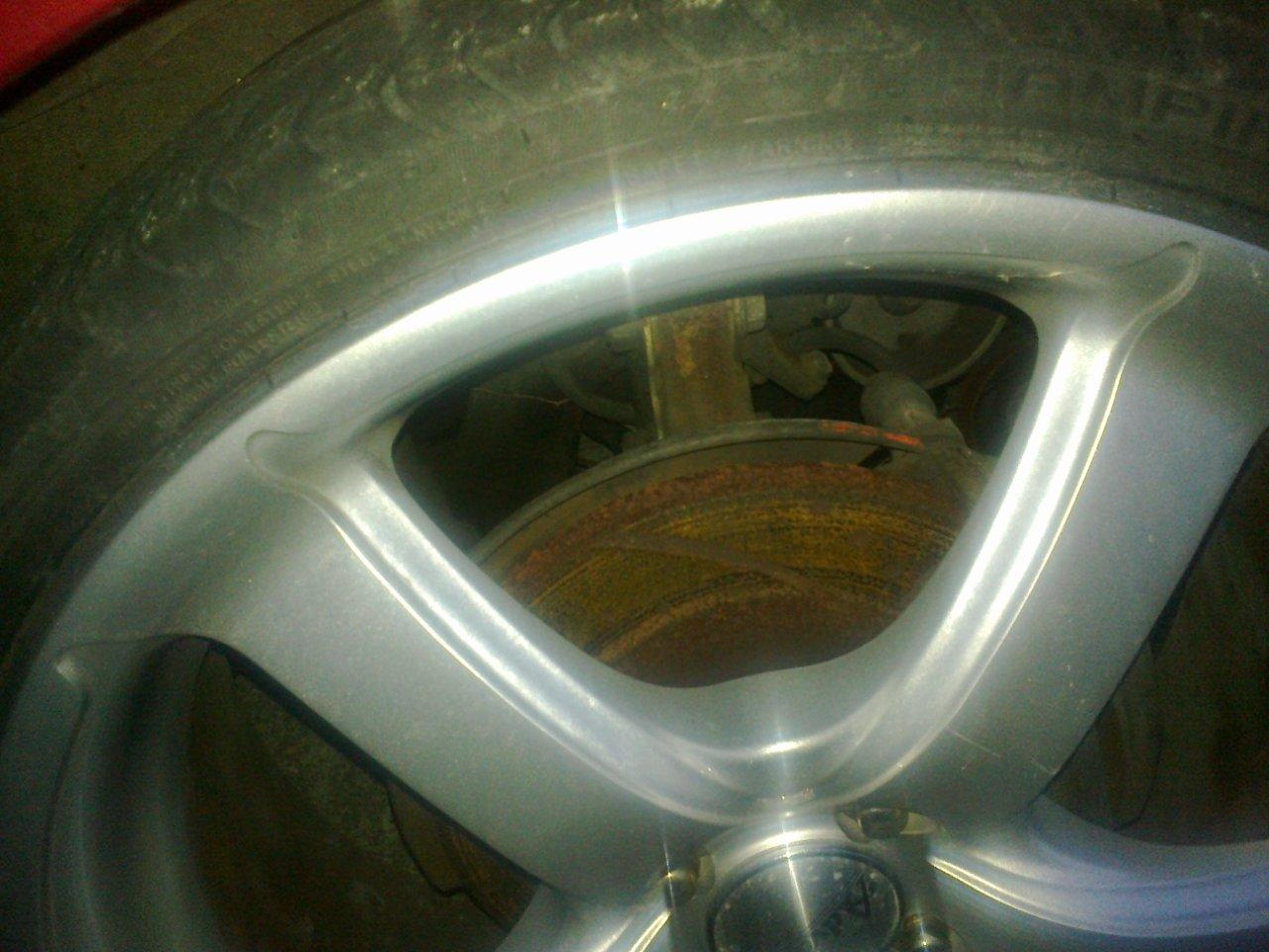

it is fitted with zenotelli cross drilled and slotted rotors and green stuff pads with dual rate munroe gt gas struts cusco camber plates, and some dual pot calipers from a different model car.
i have 4 550 cc injectors and to feed the sucker it has a 500hp walbro in tank subermsable pump.
im banking on 300-350hp at the wheels but we will see i guess it pinking becomes a problem i may have to reduce the boost getting 250-300hp.

i have 18" advanti white racing mags and an exzact set the same in silver (fitted) but they have a wider offset and clear thefront inner guards but cock up the rear geometry so the plan was to paint them all white and ues the wide ones on the fornt and the narrow ones at the rear to make the car easier to set up at the track as the factory front hubs are offset from the back ones for god knows what reason i think it is just a front wheel drive thing.
i have the zorst gasket and turbo flange lazer cut out ready to make the turbo manafold but i have to figure out whether i want antilag to spool the turbo off boost or just a screamer pipe setup which is ilegal here for road use.
you can just catch my work car in the back it is a jet black 2007 holden crewman a great car if you dont want to be able to afford to eat and it is gutless, for some reason the reduced the motor from 3.8 litre to 3.5 or something like that and say they tickled it up so it goes the same but i asure you they are wrong!!!
i think it is 12-17 litres per 100km my bosses v8 adventurer runs 8 to 12 per 100km and it is a 5.7 litre something does not add up to me?
on the roof of the car is a custom made stainless steel condiut and earth peg rack that i have useed it as a pineapple/potato gun and was a very fun experiment :-) we now call it the cannon i was going to get a sticker made for it.

Hell yeah PJ, that's a badass project. What's the weight of that car? With those mods you should be pulling all the modern muscle around (stock).
