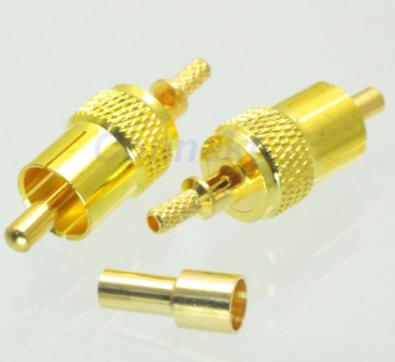

I looked at making a qsb and putting a micro controller on it so it sits over the video connector pins underneath the motherboard and it will automatically select component mode if a device is not plugged in the video socket and I would need something slim to fit between the shielding and motherboard to carry video signals up to the adaptor and I don't know if a flat ribbon would be suitable.
My alternative would be to use rg316 (same stuff used in the ipex cable's in laptop wifi aerial) but it would have to come up infront of the fan by the cpu and a ribbon would be so much tidyier solution as it could come up at the back between the network socket and the video socket?
If i could make a qsb up it would make it a lot easier to do such a mod, and as tv's are starting to loose component inputs it would be a neat solution. the alternative is to solder to the top of the board to the encoder chip but the pitch of the pins makes this almost impossible.

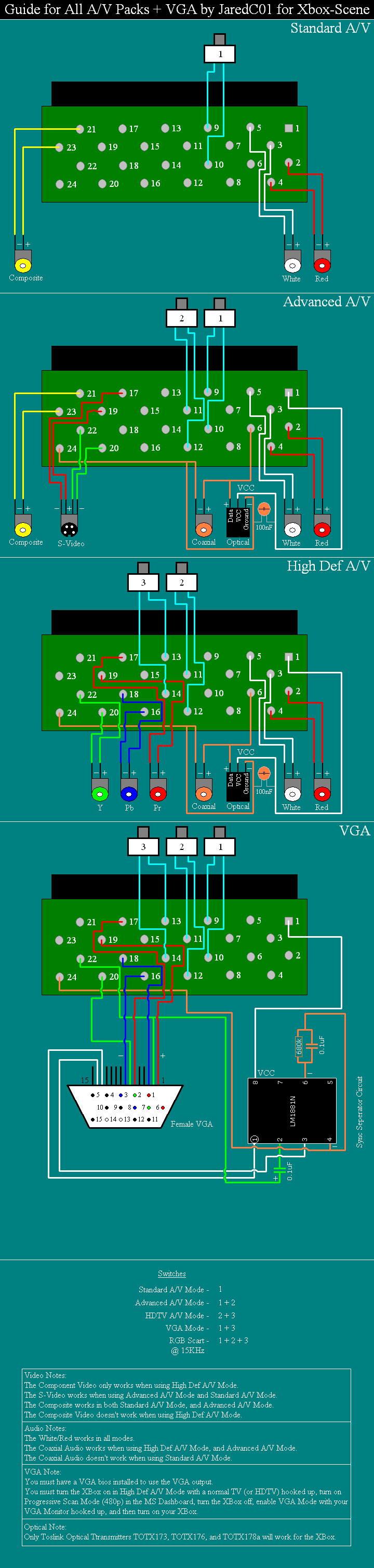

this may be of help to you
1 Vcc
2 Audio Right
3 Audio Left
4 GND (for pin 2(Audio Right))
5 GND (for pin 3(Audio Left))
6 SP-DIF Digital Audio
7 H Sync (VGA Mode)
8 V-Sync (VGA Mode)
9 Mode Select 1
10 GND (for pin 9(Mode 1))
11 Mode Select 2
12 GND (for pin 11 (Mode 2))
13 Mode Select 3
14 GND (for pin 13(Mode 3))
15 +12v
16 GND
17 GND (For pin 19 (Svideo CR and Component PR))
18 Variable (Comonennt PB)
19 Variable (Svideo Cr and component PR)
20 GND (for Pin 22(Svideo LU and Component Y)
21 GND (for Pin 23(Composite))
22 Variable (Svideo LU and Component Y)
23 Variable (Composite)
24 GND (Pin 6(digital audio))
I believe all grounda are tied to function ground so you could use the same terminal for all your grounds.
xbox avip pinout
xbox avip pinout

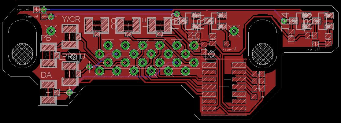

So I have spent a bit more time and added buffered h and v sync signals for vga output and made it so it actually fits on a 1.0-1.1 xbox I dont know if it would fit others I dont have any other models to look at.
I have a micro to be able to test the program operates correctly and check the signal voltages and i hope to bread board it all up to check it all works while im on holiday

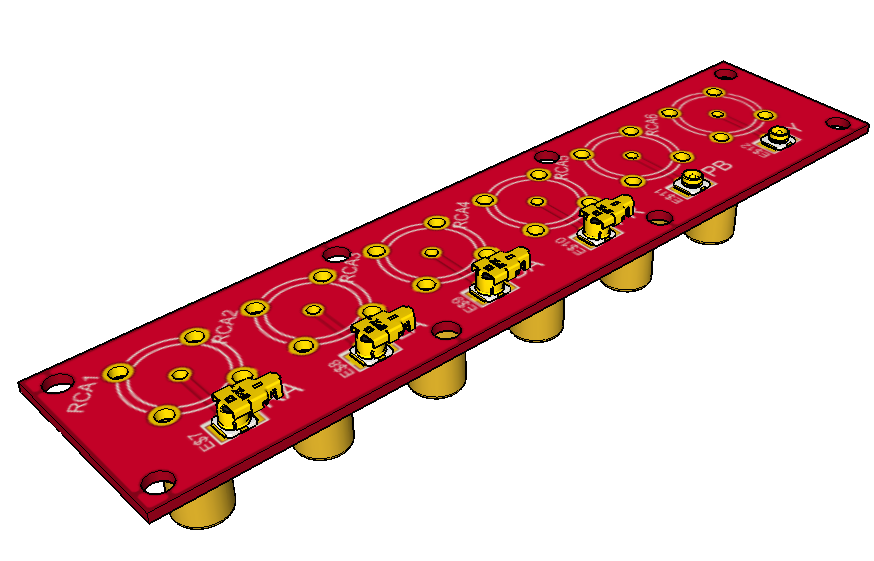

here is a 3d model I could not add the soic i need a better graphics card or my computer is running out of ram as it crashed but it gives you the general idea.
I have not thaught about pricing or as such it is a concept at the moment, it should not be too expencive I dont know really.

Sweet so it will use the little clip on wires that internal wifi cards use?
Clip onto the device under the board & solder onto the converter box.
Plug & play! (Well if you have the device already prepped)
Hit me up when you get some made & I will buy a few.

Yes the little wifi connectors under the board with pigtail up top maybe to a plug like this on the other end?
space may be an issue with this but it is an option:
If i do get around to making them it will be all premade and programmed.

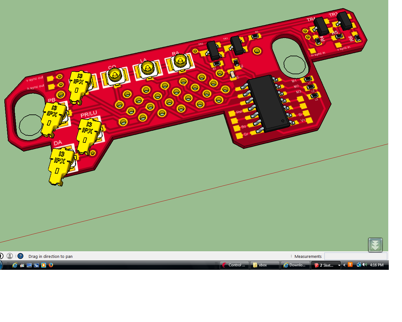

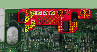

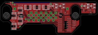

So I have done a bit of tweaking and I think I have now come up with a design that will fit all xbox boards.
I picked up a 1.4 yesterday and a have a 1.1 here and they are almost identical around the avip connector.
From what pictures I have found on the net the xbox v1.6 have plenty of space around them so the one device will fit all xboxes.

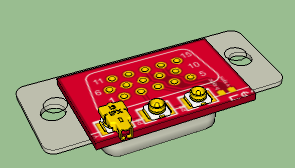

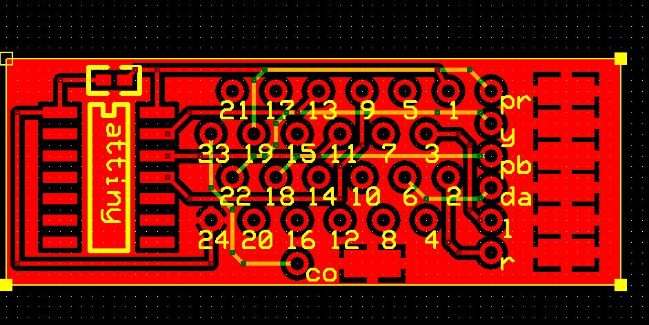

I have also knocked up a vga and component break out board options to acompany it as i know how hard it is to get a component cable of a resonable quality.
Im now looking for somewhere to get these made does any one have some recomendations of somewhere cheap but good?
I have tried local firm I know (in NZ) and they want far to much to to make them.
any ideas or any one can recommend a service ?
