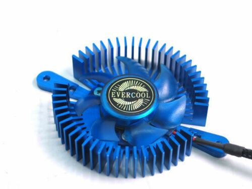

I know this is a very old thread but it seems people keep coming back! I thought I'd post here an alternative to the Iceberq 4 kit. I have personally found the Evercool "Mini UFO Universal VGA Cooler" also has mounting holes that match the Xbox board screwholes the same way the Iceberq 4 does for the CPU and GPU, and are LED lit. They do not come with heatsinks for the RAM but they do come with thermal paste included.
See image attached in case the eBay links below fade with time:
https://www.ebay.com/itm/EverCool-VC-RI ... 2248005105
https://www.ebay.com/itm/EverCool-VC-RI ... 2457072614
At the time of writing red and blue versions are available on eBay. I have seen a green one once but haven't been able to find it again.
They do come with plastic mounting fixtures that you can use to secure onto the CPU but I personally prefer to use bolts to keep them securely fastened.
I'm not sure the exact size of bolts required because I just used some from a mixture that came with a universal kit:
https://www.ebay.com/itm/Universal-Moun ... 3283297923
You can brave using the original Xbox screws to fasten the cooler on the GPU, though in my experience they are a bit short and can wear the pilotholes away and spring loose, so I ended up using bolts.
If you do end up using bolts, you will have to cut away the two plastic pilotholes where the screws would normally go in on the bottom of the Xbox where the GPU is positioned over to allow the board to fit back in properly.
These are working well in my 1.4ghz Xbox for now, though I do plan to replace them with a watercooling solution once I'm brave enough! Got a unique watercool block to fit (courtesy of N64Freak, whom has been extremely patient and hardworking to supply me my board and watercool block), just need the time and patience, and possibly the need to build a new case to fit everything in...
Anyway, without further ado, see attached image. I may come back and post images of these fitted inside my Xbox so you can see what I mean.

Nice! Thanks for sharing samspin. I have a pair of Iceberqs on one Xbox but I've always wanted to do the same treatment to others. I'll get a pair and check them out.
