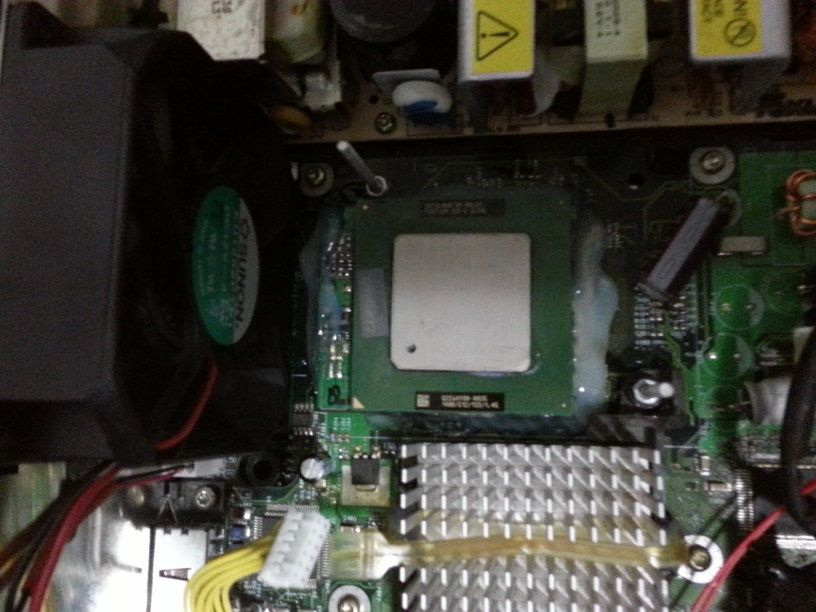

Trusty's amazing work, a 1.4ghz CPU

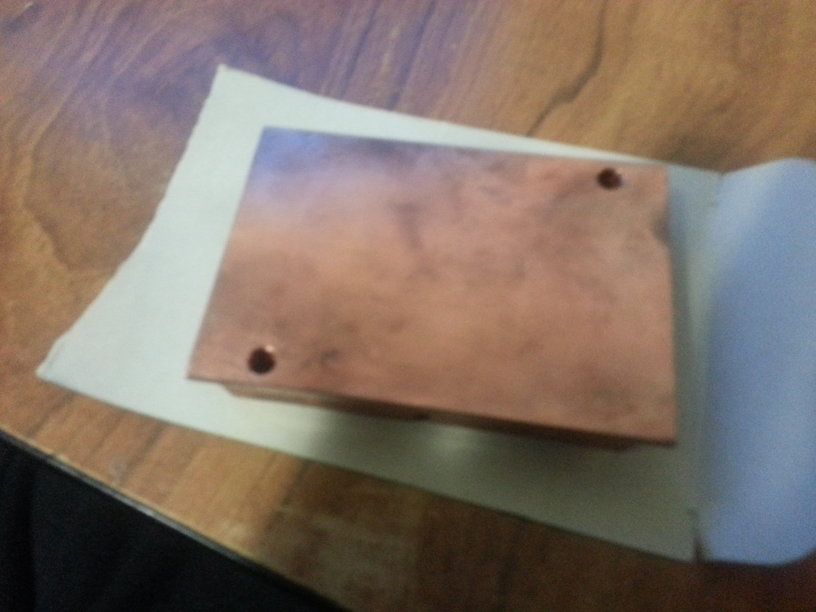

Wanted it to run cooler, so after a bit of trial with a few heatsinks I settled for a 100% copper low profile heatsink I modded to fit. Never goes over 45C now and idles at 39C - 41C. I know this is a bit excessive but I like keeping it at a lower temp.

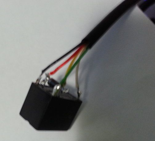

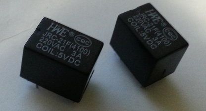

Did the internal IR Dongle and Logitech controller mod, used these small relays so I don't need to add a switch if I want to use front controller ports.

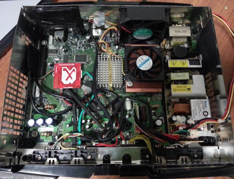

All the gear fitted, pretty tight fit but tried to keep it as tidy as possible. I'm using the case fan header for the CPU fan to bring the speed back a bit to quiet it down.

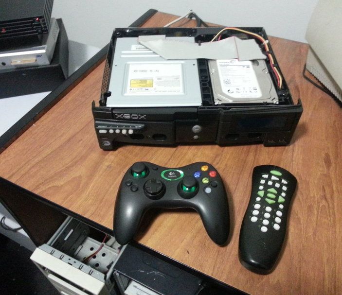

Refitted DVD-Rom and 2TB HDD with SATA adapter, tested and all working well. Loving CPU speed increase, if you use your Xbox for PS1 and/or N64 emulation defiantly worth it.

No problem. Seeing the last picture, I was thinking that looks familiar.r32crazy01 wrote:..., thanks for some rare bits and pieces Royalx
Well done with the mod.
You could cut the sides on the RF shielding for a better airflow to keep temps down.
It worked for me, as from Nextelhalo's reference.
