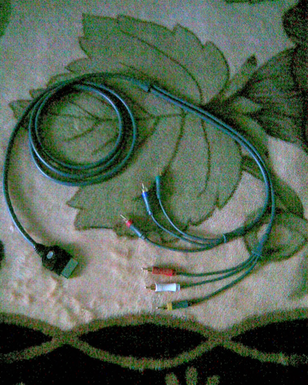

hello, i made this cable from a standard xbox cable and an xbox 360 component cable. (the composite rca, yelow one, became digital coaxial out)
the pinout that helped me is from this site:
http://www.gamesx.com/avpinouts/xbox.htm
be carefoul if you look at diferent pinouts from diferent sources, the pins are not labled with the same numbers.

Wow, you cable looks intense. I just bought a Monster component cable off ebay.
monster component cable.jpg (11.98 KiB) Viewed 10969 times
Some cables seem to work better than others. Its like the colors are off. I can change the video to PAL, i can see a picture...but the colors are off and its a bit garbled, but when I change to NTSC the picture is unreadable. Another (Monster) cable just throws the colors off, no garbled picture. I have checked to see if the right colors are plugged into the right sockets...but that's not the problem. Anyone else experience this?

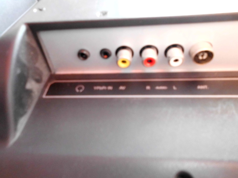

hey guys,
I want to connect my xbox 1 to my tv using componant or similar so I'll get a digital signal (audio+video) an video should be at least 480p or better 720p.
the problem is my TV has only HDMI,Scart,VGA and this one (see picture attached, the port under yellow says ypbpr) but not the 5ports for component. I also want to make the audio directly
to my 2.1 speakers (they have the white and red port). I also dont want an hdmi adapter because than also sound is on my tv boxes and they are really bad and signal would be more bad.
and when I would use this adapter http://images.marketplaceadvisor.channe ... rtcp.1.jpg, do you think it would be digital and could display 720p?
greets

The SCART connector on your TV might support RGB on the SCART interface, maybe 480p or even 720p. You need to check the manual. If it does you'll need an Xbox Advanced SCART Cable to get RGB from your Xbox - but I'm not sure what resolutions that supports.
Note that this composite to SCART converter definitely WON'T do what you want.
The connectors in your picture look more like composite (yellow) plus audio L+R.
The adapter you linked to looks like some variant of component to SCART break out, which would still require your TV to support RGB (or possibly even YPbPr) over SCART.
tim619
Posts: 204
Joined: Sun Mar 10, 2013 10:22 am
Has thanked: 25 times
Been thanked: 59 times
Re: Xbox Componant Cable
Post by tim619 »
OK thank you very much, I'll check this within the next days and then write here again.
I was just wondering if the port under the yellow one could have something to do with componant but i'll test it as soon as possible.
e: tested using my camera on the port i made a photo from but on the screen just stands AV and NTSC and quality is very pixeled like the little menu from camera just upscaled.
but it definetly supports component* now i have to check how i have to connect i do not have the manual here but could the scart adapter i posted bring digital signal? the little ypbpr port
doesnt take the yellow cable because its an 3,5 audio jack format..
*when i choose menu from which source the tv screen has to be then there stands hdmi,av,..., COMPONENT
