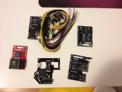

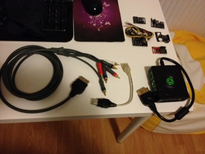

Here is my Xbox Modchip collection, also there are custom cables i made (a little bit offtopic, but i didnt want to open another post)

cashonly wrote: Wed Sep 16, 2015 7:24 am Here is my Xbox Modchip collection, also there are custom cables i made (a little bit offtopic, but i didnt want to open another post)
Great collection!
I think this is exactly what I've been looking during the last year. I did check out tour.of.britain.com website. It's truly fascinating, imo.
cashonly
Posts: 181
Has thanked: 20 times
Been thanked: 32 times
Re: Modchip Data
Post by cashonly »
Thank you!
