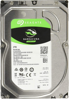

I upgraded a softmodded original XBOX with this drive:
So here is the situation and question:
Obviously since the drive is locked and has an XBOX set up, it cannot be used in another xbox, and I cannot just stick it into a PC and format it because the PC won't recognize it. I have the EEPROM from that XBOX on my PC
I am using WINDOWS 10, NOT LINUX
I just need to know what's needed and the exact procedure so i can wipe the HDD (Via format or whatever method is needed ) so I can reuse the HDD in another soft modded xbox.
Thanks in advance.
