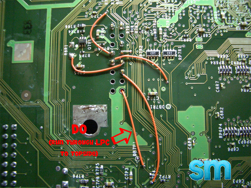

EDIT - I looked at all the wires again and on the underside of the motherboard there is a number of wires soldered (around the underside of the pin headers) and one has come loose. unfortunatly i cannot tell where the wires has come loose from. is there a wiring guide about? im hoping once this one side of the wire is reattached the problem will go away.
Ill try explain with the chip at top of mb facing away from me are the 2 rows for the pin header it seems to be a wire attached to the top header row closest to edge of board. 4th one from the left hope this helps

This is the wiring i mentioned on the underside of the motherboard
The image of the chip in question

Thanx for the reply xman. from what i can tell in the pic i think its where the top left wire is going i need to sort. checked all other wires and there all attached including the loose wie which is sill attached under the pin header. hopefully i can re solder this wire and all will be fixed.

If it is the top left and it has broken completely off as one of mine did you may need to follow the trace back further as I had to do. There is another solder location further along the trace before it disappears into the board.
