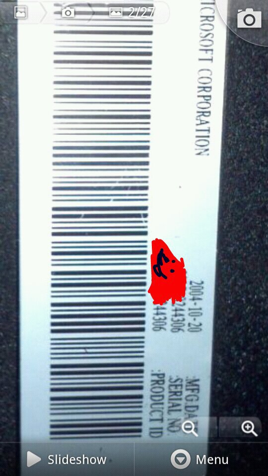

kool with this Info i Have Determined ;
it was made on Line 2, week43, in 2004
And this was the last Paragraph Before the Chart
"Now look up the box corresponding to the week and the production line in the following table. The legend below the table will tell you the meaning of the colors. Note:Anything _After 18\04_ Is mainly Unknown and is most likly to be a version 1.6 or 1.6b. "
and Of course mine Fits this Model
Soo... Back to Square 1; Ill get some
pics of the Mobo and try and go that Route ..
Thanks Buzz ...
Thanks Buzz ...
for the Info
Ps can you confirm
This guide Here http://www.biline.ca/xbox_version.htm
to be accurate ?

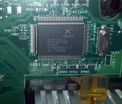

That guide should be accurate. It pulled its info from the Xbox-Scene guide (you can see the watermarks in some of the pictures). I'm pretty much 100% sure that your console is a 1.6/1.6b based on the mfg date though because I think that 1.6 consoles started production in early 2004 and yours is almost at the end of 2004. You can look straight at the video chip if you decide to open it up and you should see that it's an Xcalibur chip.

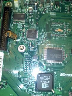

AZImmortal wrote:That guide should be accurate. It pulled its info from the Xbox-Scene guide (you can see the watermarks in some of the pictures). I'm pretty much 100% sure that your console is a 1.6/1.6b based on the mfg date though because I think that 1.6 consoles started production in early 2004 and yours is almost at the end of 2004. You can look straight at the video chip if you decide to open it up and you should see that it's an Xcalibur chip.
yea im going to open it up In about 5 min and look i was Letting it Cool down

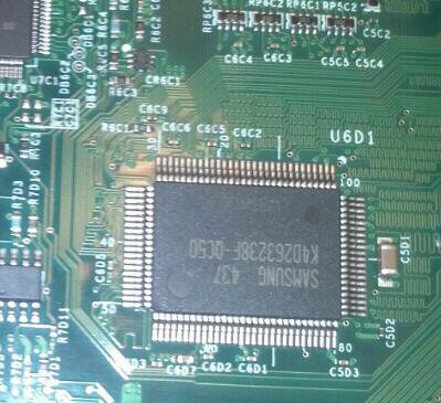

Yeah, exactly what I expected. If you're curious, you can further determine whether your console is a 1.6 or 1.6b by looking at the RAM chips. Samsung = 1.6, Hynix = 1.6b. Samsung chips can be used in 128mb RAM mods.

Yea i i saw Samsung chips Not sure witch one is the "ram" but ill google that and then Look through.my pics i took earlyer

Is this the Ram chip ? its A samsung chip
EDIT; after a googling spree i have concluded This is one of the ram Chips
Samsung …V1.6 It is
Samsung …V1.6 It is
