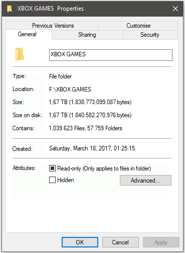

Is it possible to CLONE a HDD and then transfer it to a different XBOX and only change the keys?
I have this question because I have a 2TB drive with 877 XBOX games (yes, eight hundred and seventy seven) and FTPing this is a pain. It's so many that the XBOX can't even handle the cache on that list of games. I had to create folders from A to Z so it wouldn't crash when I opened the games' folder.
I have a few people that want the same XBOX but due to the painfully slow FTP, I told them that I can't do it. And one should never say no to friends. lol
So, the idea is CLONING one drive and having it as some sort of "master drive" and then, just getting new consoles and putting the new drives in them. The total amount is 1.67TB and over a million files.
