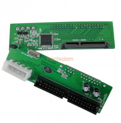

Has anyone used these cheapish wish ones £3
http://www.wish.com/c/5776117e392ac376d9784618
Sent from my Moto G (4) using Tapatalk

I've got a couple of them, they boot my 500gb hdds (seagate & western digital) without problem but they wouldn't boot my 2tb drive, one of these which are a similar price boot the 2tb hdd though.

Albatross wrote:I've got a couple of them, they boot my 500gb hdds (seagate & western digital) without problem but they wouldn't boot my 2tb drive, one of these which are a similar price boot the 2tb hdd though.
Do you use 80 wire cables ? If so which one ? I've just ordered that adapter you linked to , cheers.

I'm using this 80 wire cable, its a bit of a hatchet job though & am not sure of its longevity as I've stripped the braiding off it to allow for greater flexibility - that said I've been using it for over three months now without an issue.
