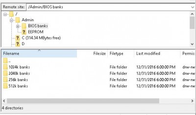

You can also FTP to the X3 modchip when in X3 Config Live. (The Xbox may be at a IP address than you access it at once a replacement dashboard is running.) When you do, the directory listing shows where various sized bios .bin files can be uploaded to flash the various banks of the X3 modchip. Just don't overwrite the banks where you have the X3 BIOS flashed. (Generally the first 4 256KB banks 1 2 3 4). You can upload the BIOS's .bin file to the other banks, select the X3 Admin/BIOS banks subdirectory.
Next, select the bank size (e.g. 256k) - depends on what the BIOS size is as to which you select - X2 4983, M8plus and iND-BiOS 5003 or 5004 are 256KB while X2 5035 is 512KB and X3 3294 is 1MB:

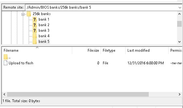

then bank number (e.g. 5):
to flash the 256KB sized Bank 5 when the BIOS's .bin file is uploaded.
