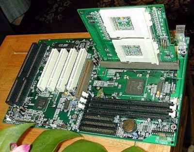

I have been trying to find one of these aparantely it adds the ability to fit dual socket 370 into a slot 1 motherboard the motherboard is special but only in the fact there was an asic on the motherboard to control the two processors would be intresting to accomplish this using an fcpga on the xbox:
interesting but far fetched:
QDI TwinMagic dual socket 370 riser card (slot 1)
info here from a:
rhttp://pc.watch.impress.co.jp/docs/article/990603/taipei14.htm
