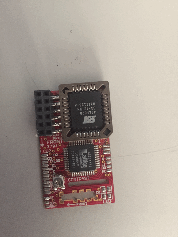

I have a Xbox 1.4v that recently I changed the TSOP to a Alladin just to make easier to flash the bios.
But, I getting error "manufacturers id 09 device id 00 !! flash not writeable!!" using spider chip.
Are my xbox still seeing the TSOP? Because everything I found this error was related to TSOP and winbond chips (I don't know if mine have the winbond thing).
My alladin have a Lattice LC4064V and a SST 49LF020
I can't know what flash code is it (bioscheck only shows MODCHIP), but since all my friend that have the same 49LF020 flashed sucessfully using "52bf" I use it as well. Please see attached the evox.ini from spider chip.
Any suggestion?
Thanks
Mauricio

Yes the old TSOP flash points are not bridged but I'm not trying to flash it. I'm trying to flash the modchip but it seams that the flash program can only see the TSOP not the modchip.
Can the modchip not be properly installed but boot and work all fine? I know that it's working and I'm booting from the modchip because TSOP BIOS doesn't have an EVOX logo in boot screen and now I can see it.
No, I'm not booting from the modchip and then pulling it out. I'm booting from the modchip and want to flash the modchip. Can I totally disable tsop?

On some aladins you need to bridge a jumper to be able to flash them as the chip will suit two different flash chips and you need to set the jumper in the correct location to be able to flash them, some were factory set in the wrong position and did not suit the flash chips installed in them.
Some you need to do a long press of the power button to enable flashing.

Mine xbox is a 1.4 and Alladin have a Socket to connect to the motherboard. The only point connected in the motherboard is BT. Which points I have to bridge? BT and GRD?professor_jonny wrote:On some aladins you need to bridge a jumper to be able to flash them as the chip will suit two different flash chips and you need to set the jumper in the correct location to be able to flash them, some were factory set in the wrong position and did not suit the flash chips installed in them.

bt connects to the button on the front panel on your one and I believe you need to hold the power button to unlock the flash but I'm not 100%
that chip is kind of hard to find as it has lcd output it is not the aladdin chip that requires modification to work correctly I believe.

You also need to ground the d0 point or it will always boot from the TSOP.
You should be able to just ground BT to the ground pad on the chip also.

On all my modchips i solder d0 from the mainboard to ground (i use the ground from the screw which is close to LPC header), and on all the modchips i solder bt to ground on the chip board.
This method allways worked for me.

What I remember form my installation is a wire from screw near LPC header to BT and another wire from screw to a point in motherboard that I´m asuming is d0. But I´ll open it again to confirm d0.

you earth D0 to force boot from external flashchip mounted on the LPC port.
The bt is used to enable/ disable the chip in most cases and is usually wired to the eject or power button on the front panel or earthed also.
