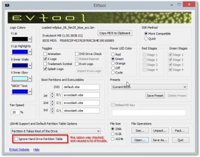

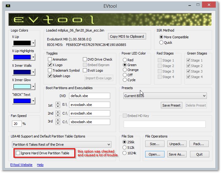

I've got it!
I backuped the currently used bios (EvoX M8 1.00.5838.01) and opend it on pc with EVtool. The option "Ignore Hard Drive Partition Table" was checked with that bios - didn't know that there is such a option.
Flashed a new created bios with unchecked "Ignore Hard Drive Partition Table" and everything works fine!
evtool settings for bios
