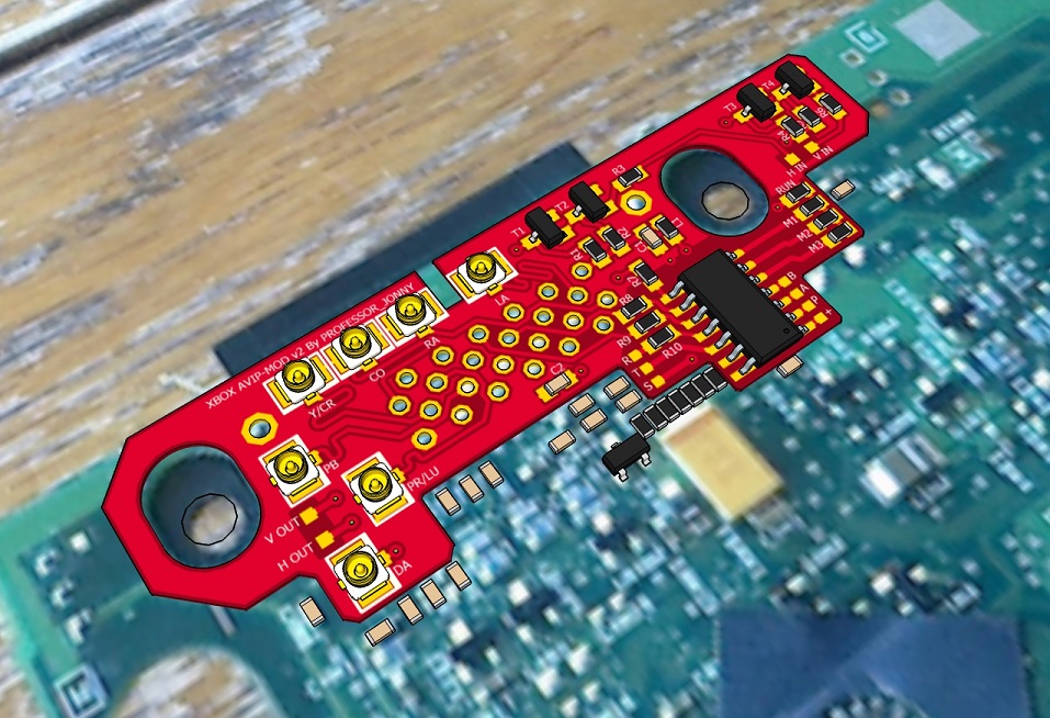

So I have used a few of my samples up now and a few local friends have my boards and all seems well now.
I have done a little tweak to the PCB design taking into account the design of the case to clear things better I still want to make a few samples to test out before I start getting too serious.
I have placed a little notch in the centre of the PCB to clear the little plastic stand off in the centre of the AV port.
I have spread out the U.FL plugs on either side of the notch and moved them closer towards the centre of the PCB so you don't have to trim off the standoff any more to clear the plugs for the left and right audio, this also will make it easier to fit in the case because of the angle you lower it down at to fit the motherboard.
I have moved the mode select jumpers away from the post in the case and hopefully they will clear the shielding with out removing it now.
I have also included a component c2 to replace C5M2 on the 1.6 PCB the cap lies right in the spot where the Picaxe leads sits, I my self removed it and placed it on the top of the motherboard with a short jumper but it would be too fiddly for people to do.
I have also included a run jumper to save an extra wire during install.
I have also placed current limiting resistors on the mode select pins and the reset trace (thanks Psyko_chewbacca) this will avoid blowing up the Picaxe if a incorrectly wired AV pack is plugged in to the Xbox or the picaxe overloading the reset line on the motherboard.
I have increased the PCB component sizes from 0402 to 0603 and will make things easier to hand solder and I have also bumped up the text size on the silk screen and made it all in capitals so hopefully it will all be readable this time.

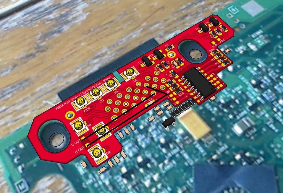

Hi professor_jonny,
I have been testing out one of N64 Freak's LMH1980 VGA mod, as well as the internal sync amplification mod. I really like the elegance of your breakout mod, but could you hook up the VGA H-Sync and V-Sync to pins 7 & 8 on the AVIP, respectively? One is supposedly used for SCART blanking but I haven't seen that used in the SCART cable mods. I'm unsure if this pin is actually unused or if there are components on it that should be cut. I like being able to use my own AV breakout box and keep my console free of dremeling and such.
Re: Xbox AVIP break out board
weinerschnitzel wrote:Hi professor_jonny,
In theory you could put the sync signals on the two pins but I would recommend you cut the traces there back to where ever they go so the normal signals are not routed there just for safety and to avoid any interference.
The lmh1980 just strips the sync signals from the green component the avip board buffers them to 5v and it a lot better idea and it will work with any vga monitor this way.
you risk damaging the xbox using the h and v sync signals directly with out a buffer.

My VGA2HDMI PRO likes the internal syncs better than the LMH1980 and the LM1881. It doesn't look like anything goes to pins 7 & 8 on the underside of the motherboard. I haven't removed the avip connector to see it top side, and I don't have a multimeter either. So I can't say for sure that they do nothing.
Since the only pin that might be used, pin 8, is not necessary for SCART cables, what do you think about adding traces to connect the amplified H-Sync and V-Sync to pins 7 & 8 on your pcb?
weinerschnitzel wrote:My VGA2HDMI PRO likes the internal syncs better than the LMH1980 and the LM1881. It doesn't look like anything goes to pins 7 & 8 on the underside of the motherboard. I haven't removed the avip connector to see it top side, and I don't have a multimeter either. So I can't say for sure that they do nothing.
The sync splitter signals are inverted that is why I believe the buffer inverts it the correct way around, it should have better compatibility with the buffer than the sync splitter, also it does not strip the sync signals from the green and this can cause compatibility issues with the actual screen but it should not as it is not part of the colour burst.
It would be simple to do your self if you wish as there are two pads available for the h and v sync as per the rough pic below, I don't think you will damage any thing on the AVIP board as it has a current limiting resistor that will protect the transistors just it may damage what ever is connected to those pins.
Don't quote me on the drawing either as I think I'm looking at from upside down and it is connected to the wrong pins but it gives you the idea.
if you wanted you could remove the shielding on the AVIP connector and you could cut them off the PCB and attach the wires to the port pins directly as the pin 8 is at the edge and pin 7 is underneath pin 8 in line.
A dab of solder on some kaynar wire would do that just nicely to make a short tail to the buffered sync pads.
I have a few dead pcb's for just this reason I will try to find where they go and, the sound pins are grounded when the Xbox is off hopefully these terminals do have the same issue I have not even looked at them.
pin 7 could be handy for a feed back or output.

Interesting about inverted signals. Can you think of a cheap circuit that can re-invert the sync signals using the sync splitter mod? I'm sure it's possible to filter the combined sync from the green line, but I also have not gotten very involved in electronics for years. Maybe it's also possible to extract the green signal and use that along with the inverted and split sync signals from the external mod.
Good idea about taking the shielding off. I'll go ahead and do that to wire my amplified internal sync signals.
Here's your mod with the right pins to wire, for the internet's reference.
