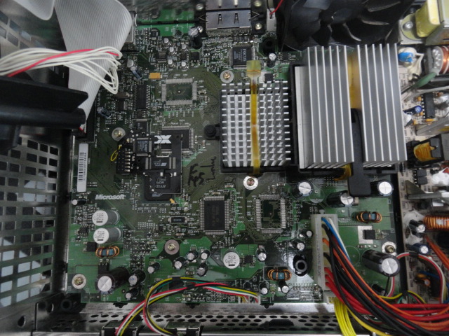

This isnt my pic, its just to point out the caps im having problems with in an xbox that has the same placement as me. The 3 im having problems with are located under the right hand heat-sink (3 in a row)
Had a look and there doesnt seem to be anything else wrong with it, all other caps look good, was always kept clean and cool etc

From your picture it looks like you have a v1.2-1.3 xbox console.
In regards to the caps, the clock cap should be removed (excluding. v1.6 consoles)
Clock cap is located within a cluster of caps on the bottom left of the MB. (SuperStor)
The caps below the CPU are 3x Nichicon HM Series (3300uf 6.3v)
I've been told that the HM Series have been known to fail (http://www.badcaps.net)
It would be recommended to use Panasonic FJ Series as replacement caps. (low ESR)
*FJ Series should also be used as replacements for the Nichicon HD caps (1500uf 6.3v)
All other caps on the MB can be replaced by Panasonic FR or FM Series caps.

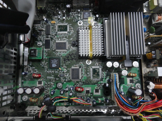

From what I remember, and looking at photos, I just laid the big caps down rather than removing them completely.
I can take the lid off and have a proper look for you if you want though?

I wrote the below and then found this picture which shows the capacitors I removed:
http://i77.photobucket.com/albums/j44/j ... NY0043.jpg
although I could have sworn I just saw an almost identical picture but with less caps in a row. The illness does affect my mind so its probably better to look at my pics than rely on my memory etc
I've had a look at the motherboard and its the same as in the photo. I've marked the obvious capacitor spaces and also the hidden one. I think its stock though as there is solder in the holes and there probably wouldn't be if I'd removed those capacitors.
I took a fair number of pictures whilst I was working on it and they are here and here.

The motherboard in the picture is obviously a v1.1asbo wrote:I wrote the below and then found this picture which shows the capacitors I removed:
although I could have sworn I just saw an almost identical picture but with less caps in a row. The illness does affect my mind so its probably better to look at my pics than rely on my memory etc.
I believe the cap on the bottom left of the MB is missing. One of the silver 1500uf 6.3v is also missing.
However the cap that is hidden is only present on a v1.0 and would be filled with solder.
Alternatively a v1.6 may have been used as it has least amount of caps compared to other versions.
Or with v1.2 to 1.5 boards, they have 3x 3300uf 6.3v caps instead of 5x 1500uf v6.3 caps...
Maybe this could be applied to the v1.1 console?
My thoughts anyways...
