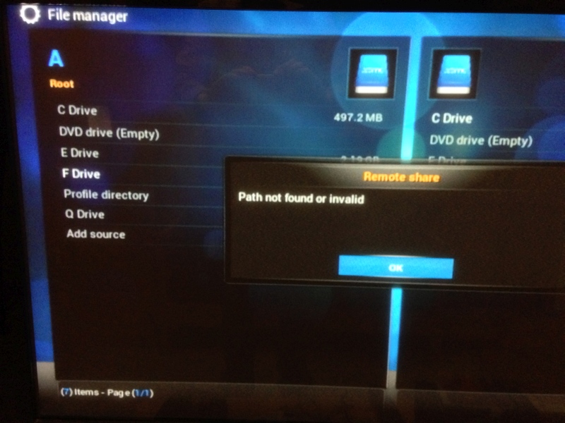

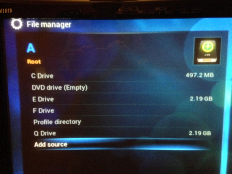

However, the partitions are still the original small sizes:
C: 497.2 MB
E 2.19GB
F ??
Q 2.19GB (i.e. same as E)
I read that you could go to F drive and create a simple text file, and the size would update, but when I try to use the file manager to go to F drive I get "Path not found or invalid".
How can I get the Xbox to see the whole hard disk?
See the screenshots in XBMC below:

format it with unleashx it worked for me. open file manager and then format f drive

Easy way:
Use UnleashX to do it, highlight the F partition in the file browser & press start & then select the format option.
Done, since you don't need more than 16kb clusters UnleashX will do the job fine.
Or if you want to use XBPartitioner.
load XBPartition v1.3, when it loads press (B), press Start & then (Y) - when done restart the Xbox.
(The above will distribute the extra space to the extra partition & then format the partition.)
If the above doesn't work, do the same but instead of (B) press (A) until you see that partition 6 has what's left of the space, that will be about 60 odd GB, press start again & then (Y) to format that partition.
You can't really go wrong with XBPartitioner, as you can only manually change the stock partitions, so as long as your not hammering the triggers & just using the (A) (B) buttons you can't go wrong.

Re: Cloned HD to bigger one - partitions still small?
Beautiful, UnleashX format has worked a treat.
