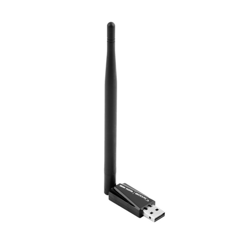

Would something like this work with the Xbox?

No, it will not work with Xbox.
You need an access point or router with AP-Client mode.

Here's a pick.DavPow wrote:I'd love to help but....
Could you post a picture of the item or another link?

Yeah, like MrMajst3r said, won't work. I personally use an old router (Linksys WRT54G) as a wireless bridge.
Literally payed 5$ for it. This is much better the the Microsoft wireless adapter too, since you can get like 4 wired devices on your wireless network. Pretty simple to setup too, aslong as your router is compatible with something like OpenWRT or DD-WRT.
