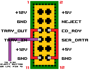

It must be flashed without the DVD Drive Option (show in my first screen) and the DVD Cable must be jumpered in special order (second screenshot).
Jumper with original cable soldered
EVtool Bios Options
EVtool Bios Options
Screenshot 2014-10-21 15.12.03.jpg (32.63 KiB) Viewed 4116 times
On my Xbox i don't have this bug. I have the special DVD Drive Option in my first Bios, but when i start my second without this Option, my box deosn't restart or hungs up.

I would recommend to not try to set the jumpers even if that would solve your problem it is still a bug and you have a risc of damage...

hmm, without jumpers some old games can check state of the Xbox DVD drive (opened/closed) ?

btw the my ticket was closed and they ask me set the jumpers
UPDATE
I make jumpers (from picture in this thread) and in XBMC 3.5 file manager works OK now (tray in menu still opened) but in system info menu still freezing and after second restart xbox bios freezing and don't load from HDD
UPDATE 2
if I put TRAYIN signal to HI state(3.3v) then file manager don't work ...
if I put TRAYOUT and CDRDY to LO state (gnd) then file manager don't work and xbox can't do second reboot ...
UPDATE 3
Ok then I'm trying some other jumpers and stiil nothing (freezing), so I guess XBMC 3.5 or may be BIOS need some from DVD ROM DRIVE in some state ...
well I need then to search some DVD ROM drive board in local trash :|
