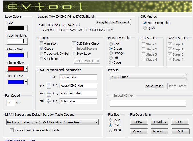

Re: How to remove "evo x" logo on boot?
If your going to mod an M8 bios how about something like this?...
The settings are something like these.....

xman wrote:If your going to mod an M8 bios how about something like this?...
that evtool looks like exactly what I need. does it just read my bios via FTP? and if so, where is my bios located? sorry for the general newbiness, I just want to make sure I don't brick my Xbox hahaah
