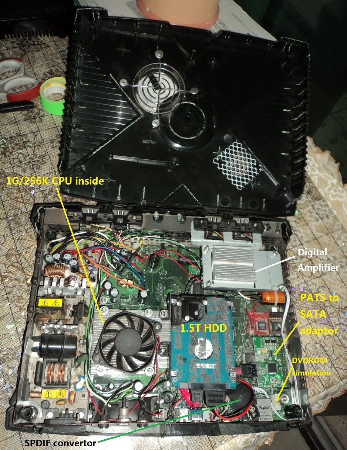

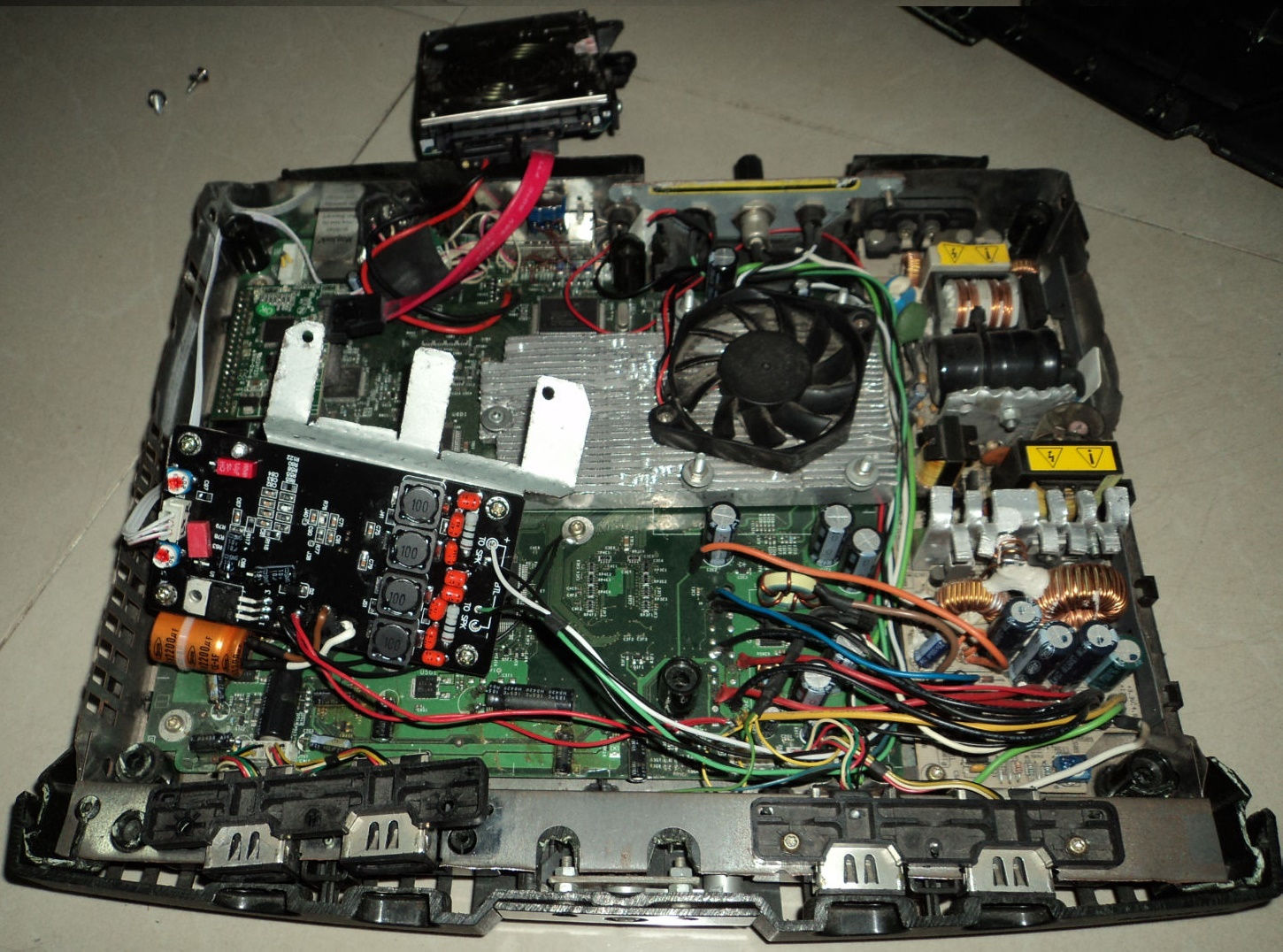

Multi connection XBOX :

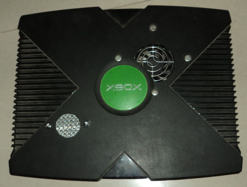

Nice, reminds me of the fun I had squeezing things into my micro, although you've managed to fit a lot more in! :)

Wow! that is cool! it makes my slim look fat again :D
amazing amount of work has gone into that too, I am surprised that you did that with a 1.6 and therefore no ram upgrade
but this is the first time i have ever seen a 1.6 that I like so 10/10

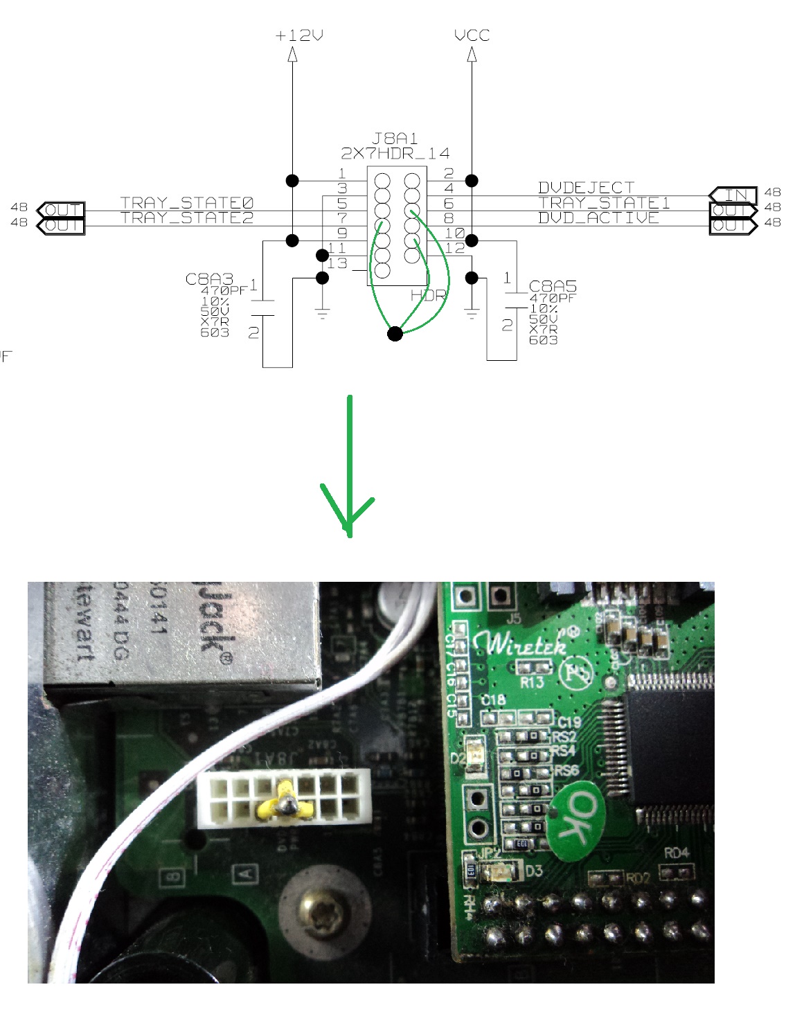

What part is the "DVDROM Simulation"?
...And what is it connected to?
The first image hasn't quite got enough resolution to see it clearly.

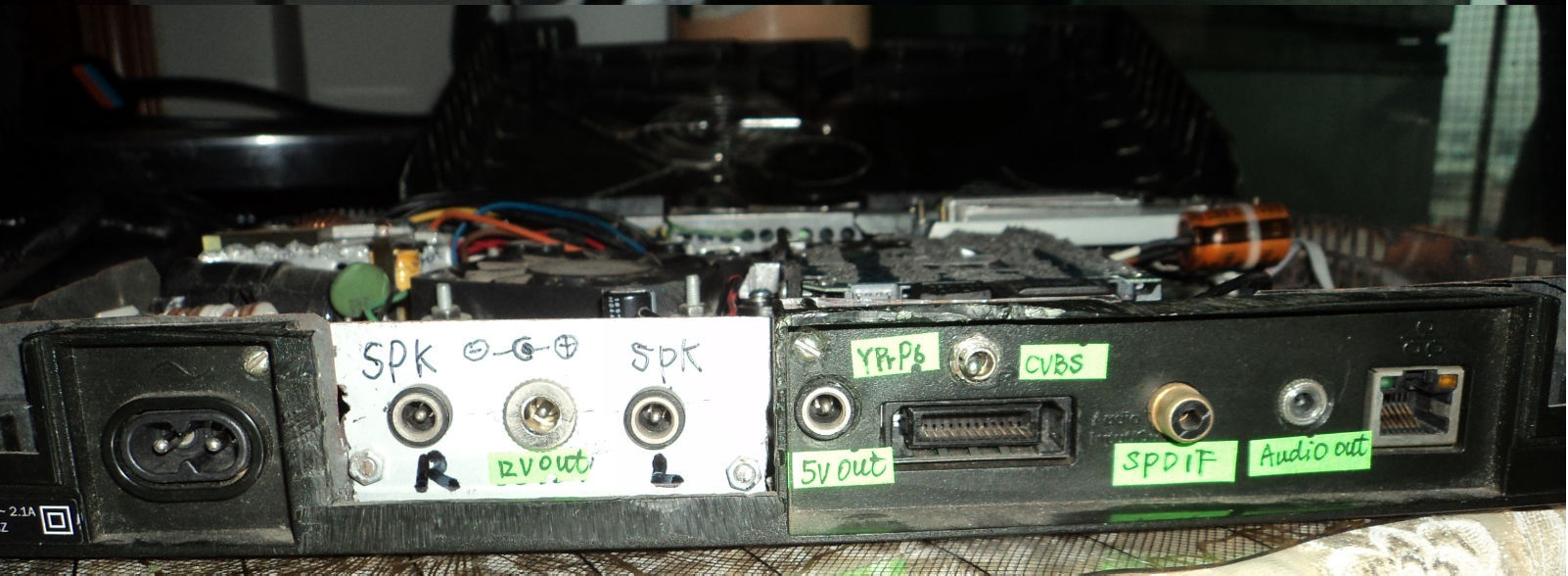

Could you give us a little explanation of things I.e the 5 and 12 v outputs please .
I love it ....

spicemuseum wrote:What part is the "DVDROM Simulation"?
Connect these pins together.
(Below is what Trusty done, by the looks of it)
Pin 06
Pin 07
Pin 10
The xbox will think the drive is closed & ready.
Pinout based on this image.
Re: Slim XBOX for fun during business trip :-)
Rocky5 wrote: Connect these pins together.
Pin 06
Pin 07
Pin 10
Ah right, ta.
So it's just a snipped off DVD connector with a couple of the important signals connected high. Clears that up, ta.

I notice Trusty uses Aladdin modchips. :D I could never get the DVD simulator to work on big arsed HDD installs and resorted to installing modded and hacked Thomson DVDdrive boards and mounted links on the board itself but the effect was the same. I used Thomsom boards because they were the smallest. Ow, by the way, you not only need to tell the machine the tray is closed but also that there is no disc in it to be read. My system is actually the opposite to Trusty's as it tells the Xbox the tray is open and therefore no way of reading a disc as it thinks the tray is open. It actually works quicker than it being closed but the trade off is the Xbox will try to close the tray when you turn off the Xbox via the button, (which it doesn't have), and the board has a time out feature that will ignore the open signal after about 2 seconds which slows down the Xbox's shutdown by about 2 seconds. This is the only side effect I have noticed and that machine is over two years old now.
The answer is same as "Rocky5"'s replay above ,...
Yes, it's telling the XBOX's BIOS that "one blank DVD drive" is presnet and healthy.

hawsey wrote:That is one very small xbox Trusty :-) I am sure 007 will have one of these next time he graces the big screen .
I love it ....
Where to we place our orders :o)
5V output is mainly for YPrPb to VGA convertor, or something(a Ethernet router or switch.... ) that you want get powered ..
12v outputs is mainly for LCD monitor , or outside auidio amplifier powered by 12V or something else that you want get powered ..

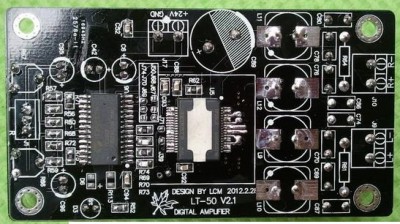

Where did you get the digital amplifier?

xboxprince wrote:Where did you get the digital amplifier?

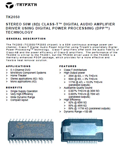

It's a TK2050 T-class amplifier baord, I bought it in Chinese market ...
L*W*H=99.5*54*27mm
