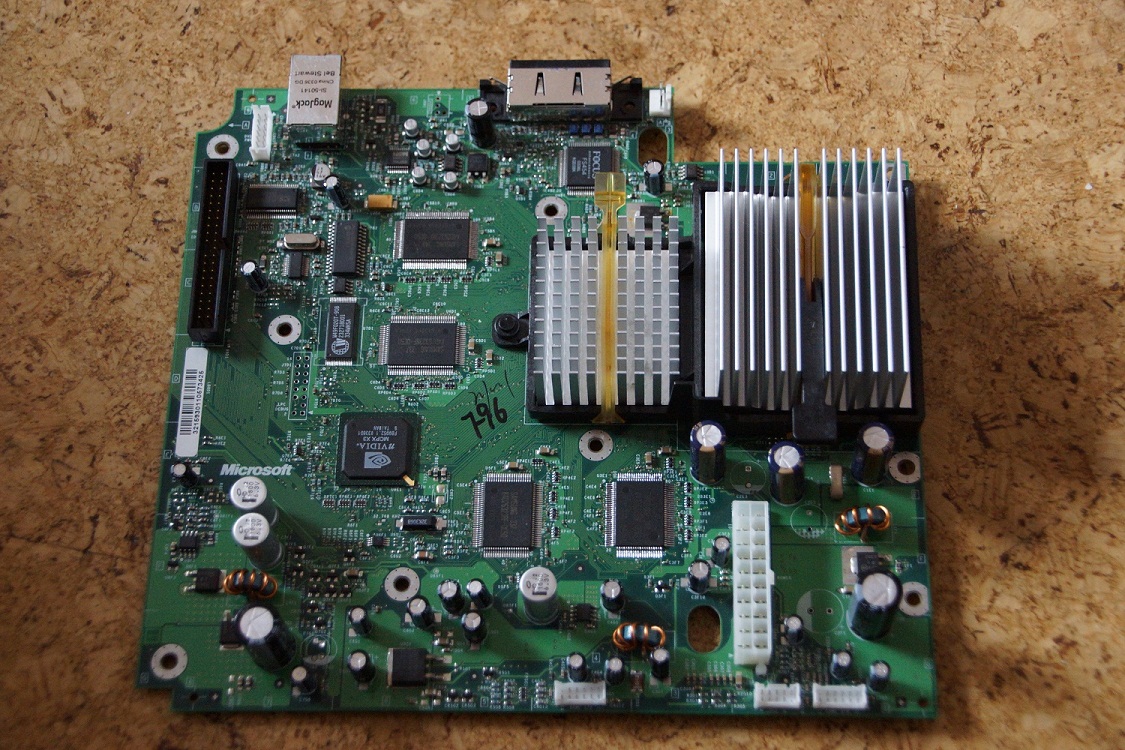

Hi,

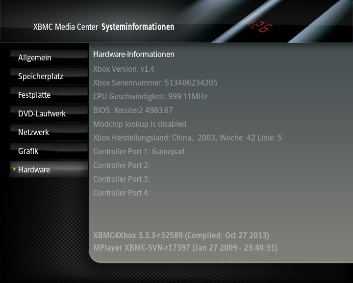

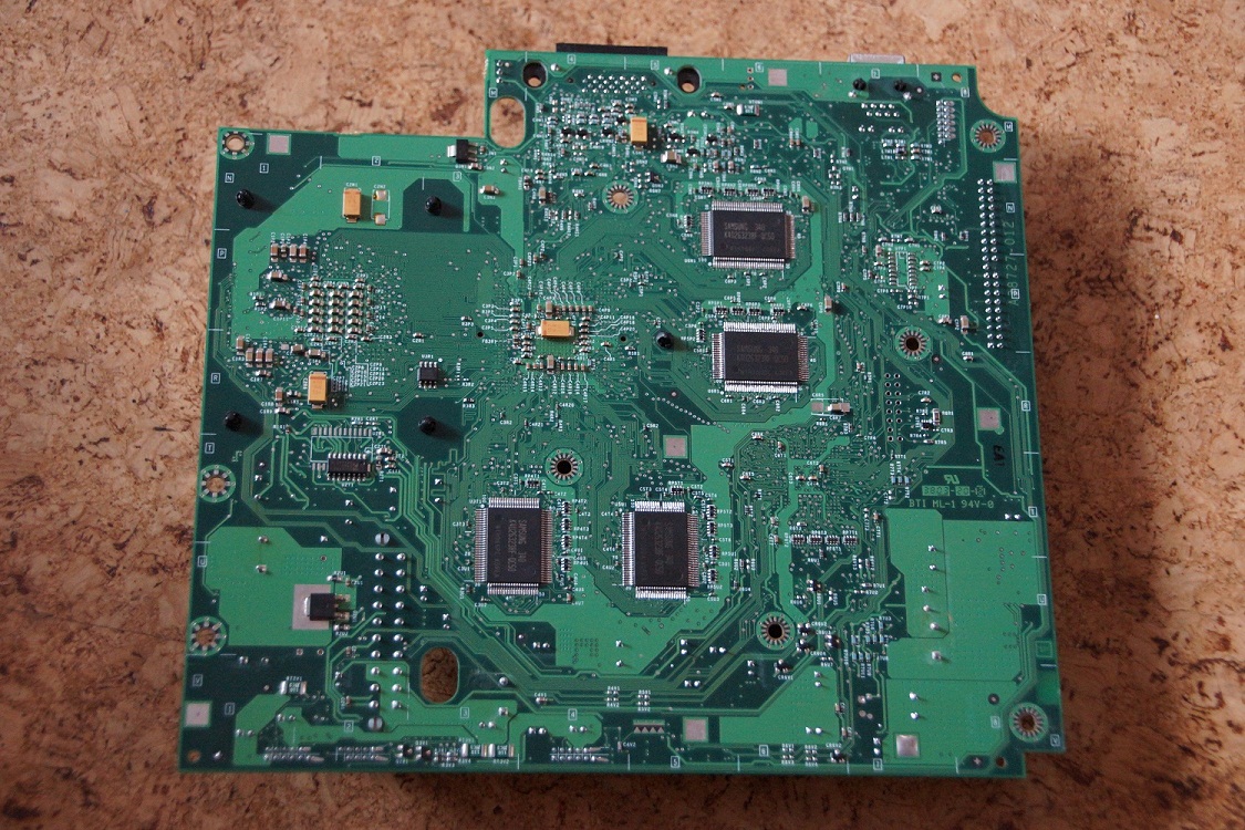

i upgraded yet another xbox V1.4. This time the motherboard got 128mb of Ram and a 1ghz cpu installed.
The tsop like allways got the Xecuter2 4983 installed and the clock cap has been removed to prevent damage to the motherboard.
The case of this xbox is pretty worn out so i would like to sell the motherboard by itself. If you want or need the rest of the parts and a case i can add them for 10€ extra.
The price for the board would be 80€ plus shipping costs to wherever you are. ---SOLD to sboexle---
I'm willing to do international shipping if you cover the costs!

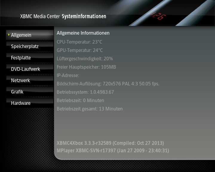

Here are pictures of the board and screenshots showing the upgrades:
