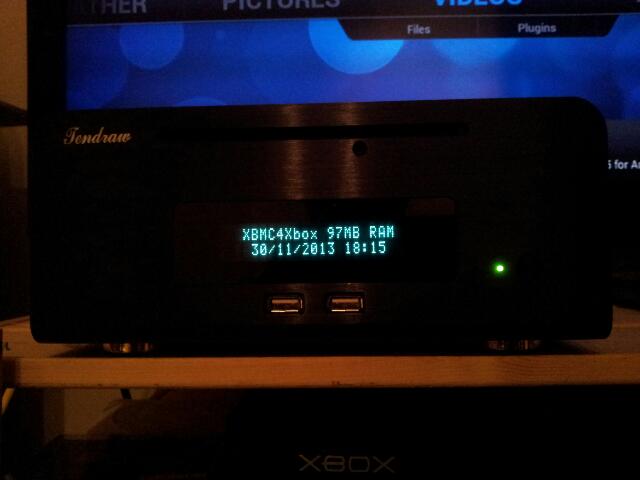

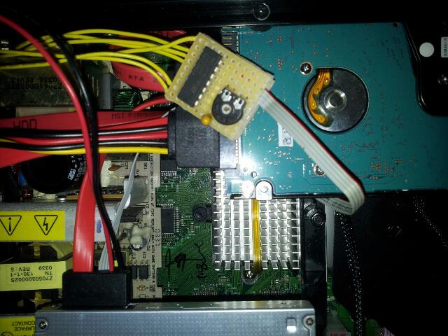

Work in progress...
128mb Ram
VFD (SmartXX v2 chip)
SATA 1TB 2.5" HD
SATA Slot load DVD writer with custom circuit for yellow cable signals :-)
Remote power on/off
Built in DVD dongle remote (using port 4)
USB ports
4sec boot time :-)
Super quiet.
Super small.
Super gorgeous
Todo... component/spdif/optical/Port 3(USB)on Back.
Inspired by the OrigenAE (those cases cost a fortune)
Mine didn't :-) fantastic quality too

Cheers guys, obviously this ones not the finished product. I will do more day light pics of internals when I neaten cables etc ;-)

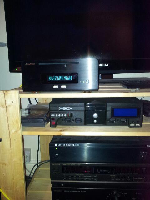

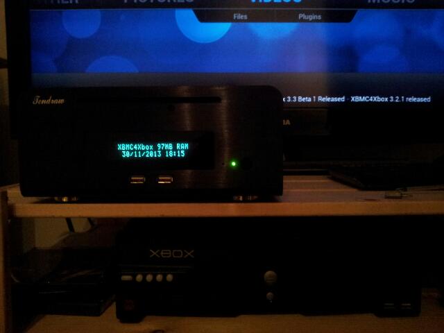

Couple more pics

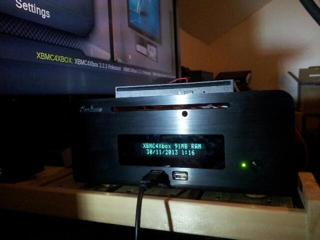

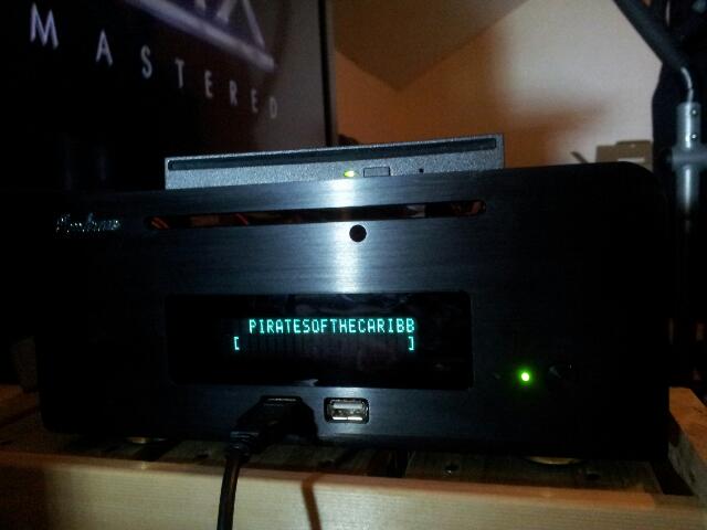

Another, a bit crap with stupidly bright flash.
Re: Work in progress - making the xbox up-to-date and sleek
Personally I love the HTPC cases at the bottom of the pic case wise but I do love the features and effort required to put all this together. Nice work.

I considered an SSD but wanted 1TB to clone my 1TB 3.5", i'm really happy with the toshiba 2.5" disk, it initializes and boots really quickly. (a 3.5" would fit in this case but It was a bit tight)
I also considered the pico dc to dc with ac to dc external psu's but couldn't justify even more cost, or even putting the xbox psu external, but I'd need to build a box with fan and getting the correct gauge wire externally may not be neat, thinner/less wires may cause issues also.

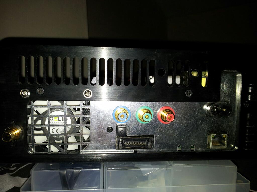

Added component video and spdif (optical + coax)
Nice work, is there a switch for switching between component and standard AVIP ?

Post by nayparm »
Cheers, its currently hard set to hidef. I have switches but was toying with adding vga also so not added them yet.
I was going to have just a vga connector and use it for both component and vga and just boot a vga bios to switch but decided against it. Not sure of the best vga route to go yet or if at all. I may just leave as is cos I keep thinking of more things to add/change/do lol.
