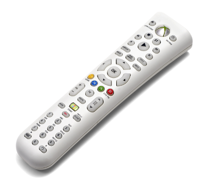

For the RPi.. You can use the Xbox DVD remote and the dongle with a USB adaptor. Like I did there:
Or you can connect an IR receiver diode directly to the GPIO pin. Like this (I used a TSOP38238):
I use that remote with my RPi and the previous GPIO IR receiver:

Any idea whether this will work by default with my X80X remote?
