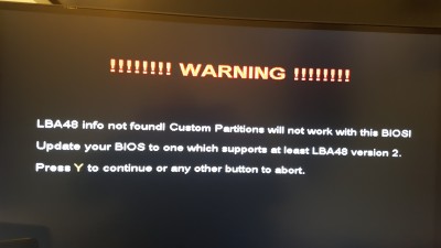

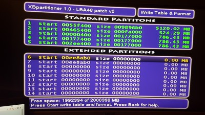

I think I need a BIOS update too because Xbpartitioner was saying LBA48 info not found, custom partitions will not work with this BIOS etc.
2TB. Any reason this will not work/be fine?
What should I do now?

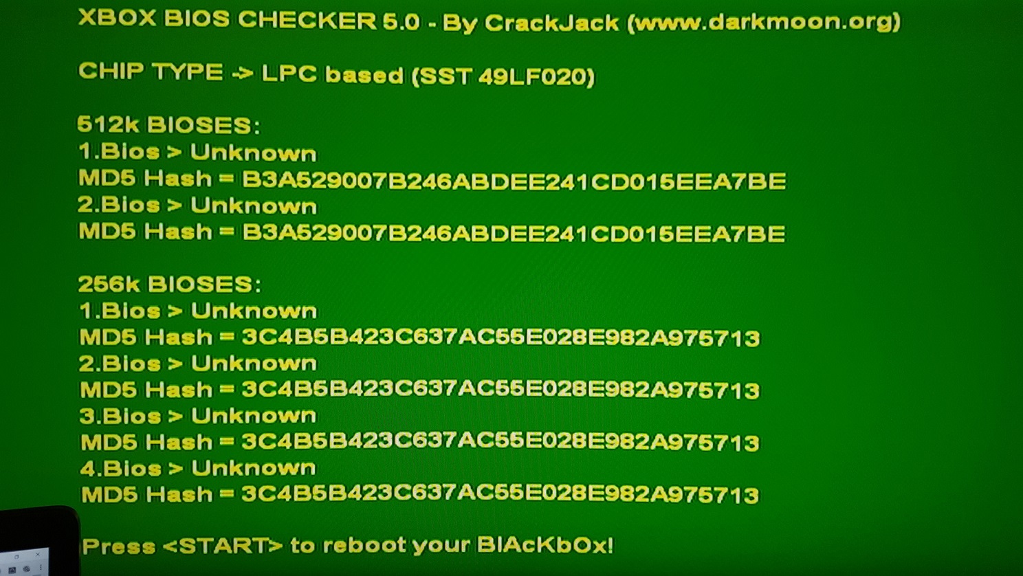

The bios checker on the Evox disc was unable to detect the version.
The formatting did not work

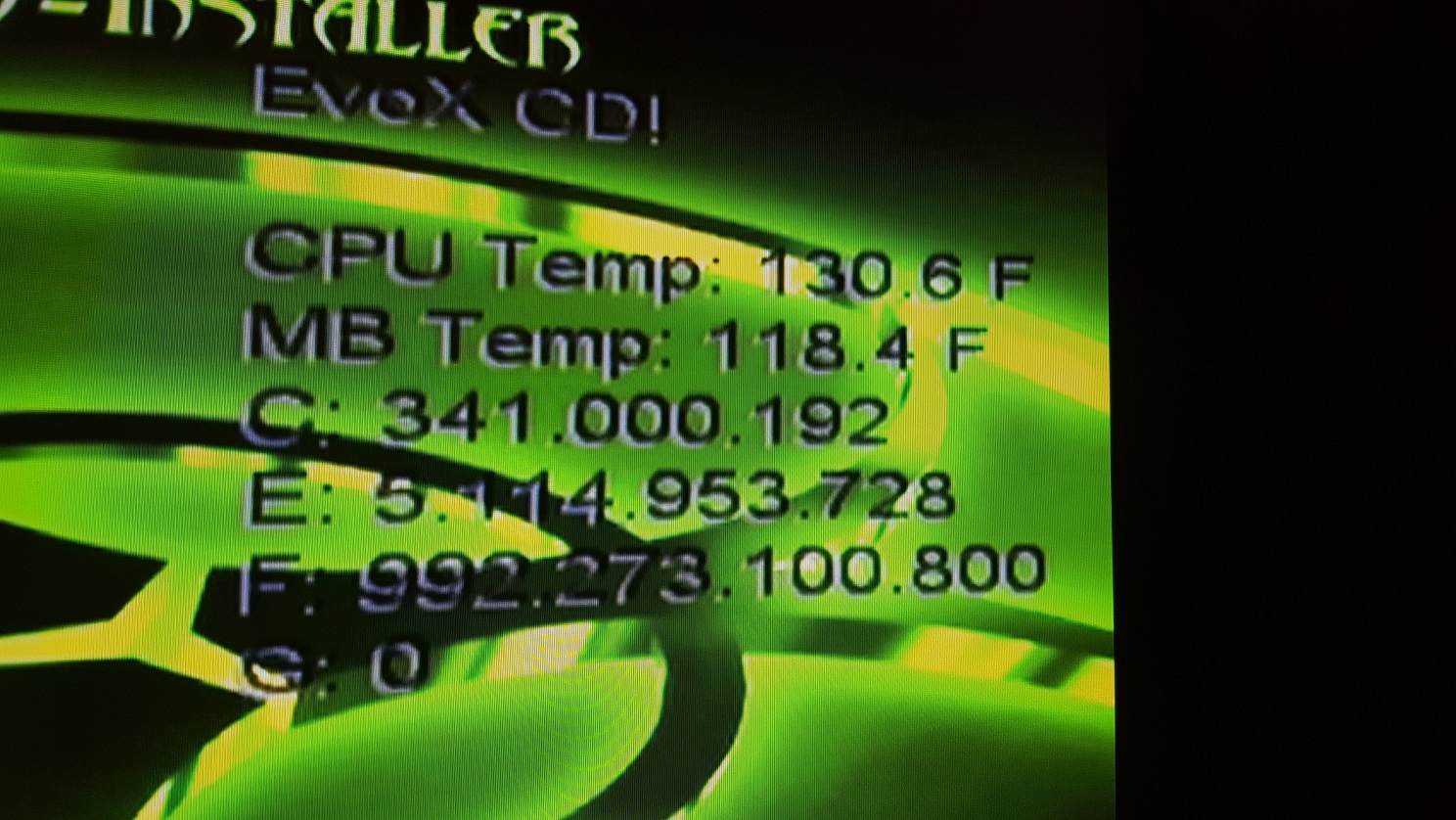

I have an Xecuter2 mod. But when I have selected the auto installer from the Evox disc, it did format F with all the remaining space up to What should I do now?

Apparently I need bios at least X2 5035 for the LBA48 support but cannot find any links which are still up for it.
Anyone have the files somewhere on their computers?
Re: XBOX 2TB SATA Upgrade Tutorial
X2 5035 ( 512kb ) is the minimal released x2 bios that supports the partition table ( LBA48 v3 ) use the M8+ bios instead.sd_dracula wrote:Apparently I need bios at least X2 5035 for the LBA48 support but cannot find any links which are still up for it.
Unless your chip works with 512kb bios.

Currently UnleashX detects the F partition with the remainder of the space up to 2TB. What happens if I leave it like that, without splitting to F and G? Data corruption?
Also I do not remember if the X2 is 256 or 512kb, how can I tell which I have?

I can send you it if you want. ( all x2 prior to 5035 are 256kb )sd_dracula wrote:Thanks Rocky.

Managed to get the chip flashed with M8+ and was able to use XBpartitioner to run like in the tutorial.

3. I have enabled use drive G in both UnleashX and Evox dashes but when I FTP to drive G it displays me the exact same files I have on F. How to fix this?
However I do have a few issues:
1. The in game reset seems to do a full reset and then error 07 instead of returning to the dash. Need to power off and restart each time. Need to fix this.
2. For some reason when using UnleashX dash the FTP transfers are very very slow. If I go into Evox seems to be fine.

Error 7: HDD is timing out.sd_dracula wrote:Managed to get the chip flashed with M8+ and was able to use XBpartitioner to run like in the tutorial.
1) caused because of your sata adaptor.
2) same as 1.
3) make sure XBP v1.3 is formatting the HDD correctly, or use Chimp 261812. But it could number 1.

So I used XBP 1.0 and then 1.1
Then I used the 1kb file test and free space changed accordingly.
Odd how that error was not coming up before with the older X2 BIOS and transfer speeds were just fine.
If I change the reset method will it help?
Is my LBA48 setting wrong? I had left it as it was on the bios file, just changed boot order before flashing.
See below for the M8+ bios settings:

sd_dracula wrote:So I used XBP 1.0 and then 1.1
https://s23.postimg.org/n44ji44ln/Untitled.png
Image is fine, M8+ will use the onboard partition table unless you tick the box for it ignore it.
Also FTP has nothing to do with the kernel (BIOS) its a dashboard or HDD issue, now that your drive is using its full space instead of being glitchy like before its now more than likely your adaptor that's the issue now.
Also make sure you are using the correct version of the bios, there are 2 versions one for v1.0 to 1.5 "M8plus.bin" and 1 for v1.6/b "M8plus_16.bin".
And never use anything other than Chimp 261811/12 or XBPartitioner v1.3 ( v1.3 fixes the need to use v1 + v1.1 to format the drive )
