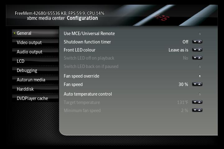

When I have the HD component cable hooked up the XBOX splash screen looks normal. However, when the XBMC shows up (3.5rc2) the screen has the bad green tint to it. It works fine with the SD cable though. I also can't get it to chance over to 720 or 1080. I select either resolution and XBC does not recognize the command...just ignores that I have selected these resolutions. Took this screen shot to show the green tint and it is showing up perfectly. :roll:

Re: Green Tint
If the image in post one has the green tint, it's not sync on green, as that makes the screen almost lime green, you lose all colours bar some pinks & green.
If your screen looks like image two, then nkpatcher is outputting in RGB mode.

It is the second image on an NTSC console. Burning your disc now. Do I just run default.xbe?
