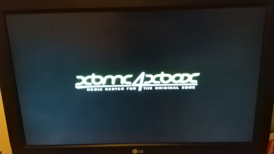

The problem is that when I want to use the Xbmc app (old version) the app freeze at the startup display.And then the only solution is to restart the Xbox.
I tried with the last version for the same result...

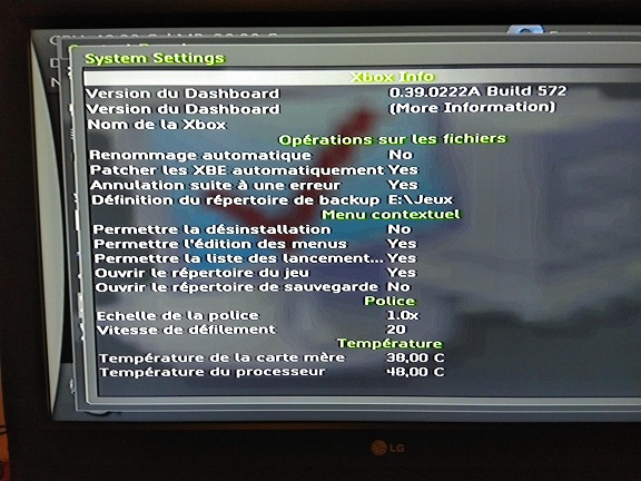

UnleashX is not a softmod it is the main dash you are using.
Why XBMC is failing to launch could be down to many reasons but if the UnleashX main dash boots OK, as it sounds as if it must be, then any XBMC download, correctly installed as an app in Apps, should be bootable from the main UnleashX menu > Applications.

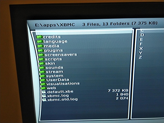

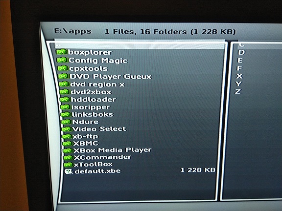

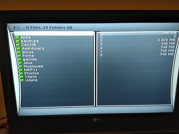

You will find below pictures of my E directory, hope it helps.
Thanks,

There's nothing obviously wrong that I can see which would cause the problem. Although I'm wondering what that separate default.xbe is doing in E:\apps I don't think it would cause XBMC not to launch. But if you were mistakenly trying to launch XBMC from that, whatever it is, it would explain why it didn't work.
XBMC launched using its own default.xbe left inside the XBMC folder, via the file manager ie. E:\apps\XBMC\default.xbe should boot wherever it is located on the Xbox. The fact it is not suggests a problem with either the XBMC download/install or a settings issue, possibly a dodgy skin file. If you installed the current XBMC (v3.5.3) over the old one you mentioned the skin it was using might still be the one selected. If it is broken then that might explain things.
Simple solution: download another copy of XBMC preferably from a different source. Put it in a temporary file on E:\ or F:\ and try launching that from the UnleashX file manger.
Also try clearing the contents of the E:\CACHE file that can sometimes interfere with programs launching properly.
This is a bit far fetched but as you also have a F:\drive; is there any chance you have another XBMC copy in there?
If you have two or more copies of XBMC the default.xbe will be named the same ie. XBMC. Therefore when you install the new one in E:\Apps I think the UnleashX dash menu will only list the existing one in F:\Apps or F:\Applications as it was there first. You may have not been launching the newer XBMC install.
If it still does not boot I'm sure others here might be able to work out what is going on if you post the XBMC log file (just copy it and change the extension to .txt) or at least the relevant part which might show what element is causing the crash.

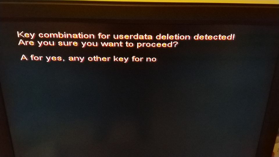

Hold down both thumbsticks (clicked) when launching or booting XBMC. This will cause a screen to pop up asking you if you want to reset your settings (including the active skin) to the defaults.

What I hadn't noticed before is that you have both XBMC and XBMP (Xbox Media Player) in E:\Apps. Xbox Media Player was the very old name given to XBMC so you do have two "XBMC" installations and there is the very, very vague possibility they might be conflicting. Try backing up XBMP somewhere else and deleting/moving it from E:\Apps. Reboot and relaunch XBMC from the UnleashX main menu again.
I see that the F:\drive has only about 500MB free space which suggests it could be quite full. What size of HDD are you using? Have you checked that F:\ was correctly formatted? It can cause weird issues although usually just to F:\. Use XBPartitioner v1.3 and if there is an "ER" against Partition 6 then it has a problem which needs addressing even if it is not related to this XBMC launch matter.

I held down both thumbsticks (clicked) and press but the app still freezing.

I have a good news, I have now a new 80 gb xbox HHD moded ;).
I used the XBHMD build of Rocky5 and it's working.
If I want to use the same method for softmod my genuine HDD, should I unlock the HHD before "create" a "new" HDD ?
Unfortunately, I install XBMC4XBOX from the extradisc tool of rocky5 but it's still not working. So it's definitely not my HDD which are in cause, it's an issue about my XBOX.
I really don't understand why it's not working, as far as I remember XBMC worked many years ago..
I think I will try to modify the advancedsettings as mentionned on the link posted by Xphazer.
But if it's working, I read that some people mentionned that after this modification the CPU still at 100%, do you think that it could be damage the machine ?
