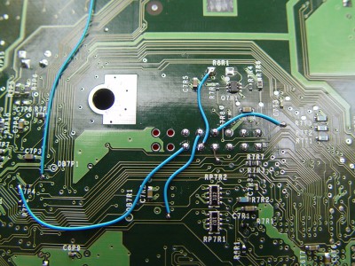

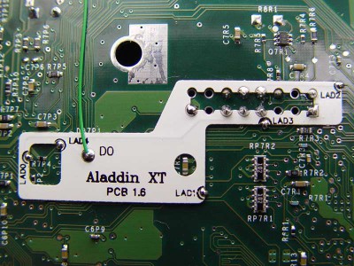

Found some 1.6 install Pics that may help. I don`t know how hard
it is to find pcb`s but the wire install here looks clear enough.

You have to connect the D0 point, that tells the Xbox to boot from the LPC bus.scroeffie wrote:so i installed the pin thing and connect bt to ground on the chip put the chip on the pins
start xbox nothing happens ? what is do point ?
(You only need to ground the D0 point since you won't be booting the retail bios as its not needed.)

Hello,
just found DuoX2 GS (blue) from old stuff. Obviously I had to buy second hand xbox, but I can't find any guide for how to install GS. I can find for normal DuoX2 and guide always says it applies for every version of DuoX2, but.. no it doesn't. GS has some kind of extra circuit board which is never covered in guides. Is there any good guide for specifically DuoX2 GS?
Edit: Circuit board says "1.6" so is it only for Xbox version 1.6? Installation would be just to solder pin header to mobo, chip to pin header and wire to d0? AND to remove extra pins, like in this diagram http://www.knightdiscounts.com/VideoGames/modchi153.jpg pins between H and I?
