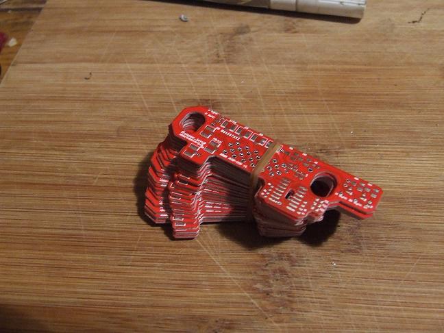

On another note I have some proto type boards and they all fit great apart from the locating/ mounting pins on the avip socket need to be enlarged but for a proto type not to bad I guess they will work well for testing.
I have reamed out the holes with a very fine drill bit by hand and now everything lines up perfectly and is flush seated with the motherboard they dont actually need plating on them as they are not connected to any thing any way.
They are very good quality for what I paid I'm impressed but they missed the solder mask on the vias on the bottom I specifically asked them to make sure they do so there is a potential for shorts if there is exposed copper or solder on the motherboard, also Few issues with the text size being illegable but I'm happy with the outcome.
SoIi have learned from this exercise you get what you draw even if I ask for something if it is not in the gerbers it is not going to be done, so a dab of solder mask will have to do the trick or some kapton tape or something.
It will also require a small change for a production board as the vias cover the landings of the mounting/locating pins for the socket and as the vias are not solder masked it will require insulation manually with me applying a solder mask or sticker of some sort.
I would also like to move the H amd V sync out put terminals just above the digital audio U.FL socket so the vias will be clear of the landing zone for the mounting pins of the socket.
So there will be a few minor changes nothing too serious but these ones will do for now.
Also I don't really deal with too much smd stuff and I now know that 0402 is not universally recognised as metric size for an smd pad, as I went to stick on some capacitors and they are twice as long as they are meant to be, oh well I know for next time![Smile :-)](./images/smilies/icon_e_smile.gif)

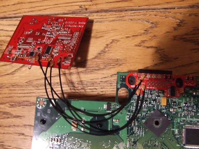

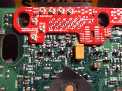

I have been busy with other projects non xbox related but I finally received some sample u.fl connectors from overseas and I have done a little bit of testing but I need to get my scope out and do some signal integrity checks as I'm as per say not using the proper impedance plugs on the cable as they are 50 ohm not 75 ohm but I got them made with 75 ohm cable.
I did not see this being a problem as rca plugs are not 75ohm either and they are used for video signals and it all seems to work ok on every component or coax audio device on the planet but I want to be 100% certain I get no reflections or ghosting artifacts etc...
The other option is to use H.fl connectors that are rated for 75 ohm but they are several magnitudes greater in price compared to the little brother U.fl ones, and trying to keep the price in check is the issue.
So below is my current play thing and I have modified an ebay sourced component to hdmi board with coax audio slightly to include U.fl plugs wiping of the rca's in the process, for all purposes it is working great but I need to do some further testing and some mods to the program.
I think one of the av pack types is muddled up I have got lost in the negative binary logic, but I have now implemented every possible binary pack combo even the unused ones. This will allow me to test the unused modes to see if I get any signal outputs, there is no indication of what they do if anything on the net.
I will have to work out a method of labeling or marking the connectors or cables as every time I unplug them I never know which one is witch and end up pulling the board out so I think a small band or heat shrink may be on the cards or colored cables or something.
Note 0408 smd components suck never try to hand solder them, I'm going mad squinting at the pcb's soldering them, kids bumping the table and loosing them etc.... so there will be a revision to increase the sizes of the resistors footprint's for sure![Smile :-)](./images/smilies/icon_e_smile.gif)

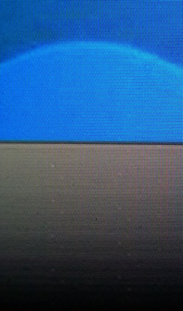

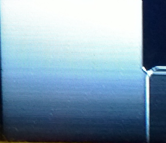

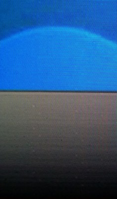

This post is more to do with picture quality I have been having a play around and I want to capture some picture to show you all before and after but the only method I have is to put a camera in front of the tv, would any one have a suggestion ?
I do get screen flickering (bright/ dark) just on the threshold of noticing it, if I turn on the digital noise reduction on the tv the problem goes away, I suspect the converter quality is the issue, as I see no problems with the component integrity up to the hdmi board.
would any one have a hdmi converter and experience a similar issue.
on different resolutions in stead of being the whole screen it is like a comb effect cross the display and it seems to be worst a 567i mode and is almost invisible at 1080i.
on some resolutions I get a sparkle like snow effect but it is allways in the same position on the screen.
I could put component outputs on the back of the xbox and use a direct component connection but I don't want to cut the plugs of the sample u.fl cables.
I forgot to mention the sound seems to do the same thing via digital audio connection (quiet loud) from the motherboard and that really stumps me as it is a digital connection not analogue!!!
does any one have more insight on what I may be experiencing and what may be the cause of the issue ?

I have a couple of suggestions PJ. I'm sure you have tried some or all of them but I'll list them all just in case, can't hurt can it?.
1- The converter is powered by the Xbox power supply?. Try powering it off the DVDrive connector's 5 or 12volt pins rather than the power supply to mother board connector. Two reasons, I don't know how noisy the 5 or 12volt from the Xbox Power supply actually is. The board caps may be there to filter out the noise. The other reason, you won't have supply wires running over the board that could be picking up noise simply by the way they run over the board getting to the converter to power it.
2- Connect the video ground to the audio ground and ground that to the cage in the Xbox. It should be already but just a jumper wire will confirm all is actually good.
3- Make sure the power supply mount screws are actually tight and the surfaces on the bottom of the Xbox power supply touching the metal cage in the Xbox are clean.
4- Check your cables from the machine to the T.V. itself. Simply wrap the cables with aluminum foil and connect a wire from the foil to the Xbox metal cage. If you notice any changes, your cables or there grounding is at fault.
5- Open the converter box and see if there is any type of power supply inside it. It may have one that is isolating the supply from the Xbox. You may need to bypass this, if there is one, and power it direct from the Xbox's supply so all the grounding will work as designed in the Xbox.
Without seeing any parts 1st hand, I really am clutching at straws PJ but maybe something here may have you looking at something you may have not thought of. I wish you good luck and hope you have these issues sorted soon. I need a couple of these boards when you have them sorted.![Laughing :lol:](./images/smilies/icon_lol.gif)

If you have an oscilloscope, you could try to probe DC voltage supply lines of the HDMI converter unit. Cheap chinese electronic devices includes cheap DC power supplies most of the time. These are generally made to supply a high amount of current but with lot of ripple. Video converter circuits require clean and sufficient power source to properly operate, especially when analog signals are involved!professor_jonny wrote:This post is more to do with picture quality I have been having a play around and I want to capture some picture to show you all before and after but the only method I have is to put a camera in front of the tv, would any one have a suggestion ?

So I have done some futher tests at all resolutions and I only start to get a problem at 720p and 1080i all other resolutions offer perfect display over hdmi.
Below is the sample pictures at 1080i and 720p
You will see slightly off vertical dots in packs of three in the 1080i image, following a diagonal pattern
You will see vertical dots up the page in a vertical pattern in the 720p image.
To be honest I'm nit picking unless you really looked you would not notice the dots.
where the picture is dark these dots are not present.
These dots are static across all displays even moving pictures.
of note turning on the soften function makes the dots more noticeable.
These dots do not show on component cables when outputting the signal via an avpack with the converter hooked up and powered.

the important chips on the board are:
CS8416 digital audio decoder
cat6613 hdmi transmitter
cat9883c Triple 8-bit Video A/D Data Converter
LM1117 regulator *4
there is also the micro but it is really hard to read the info on it
all video lines have a dual stage filter with a resistor in series with the signal and a cap to ground then it has a resistor in series into the a/d converter and a cap to Ground on the input.
as you see the filtering on the regulators is not all that flash I have restored the whole board to before I played with it.
