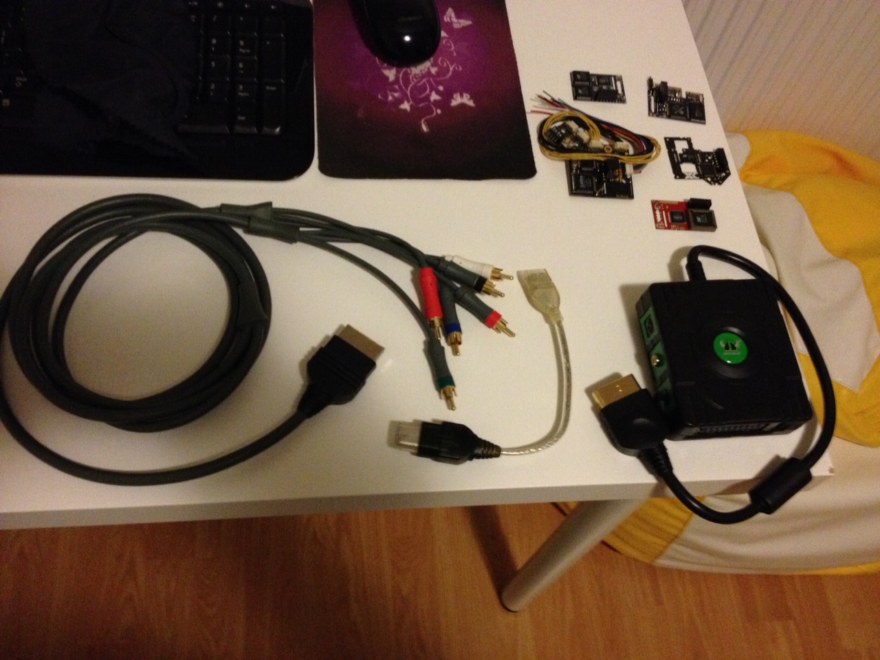

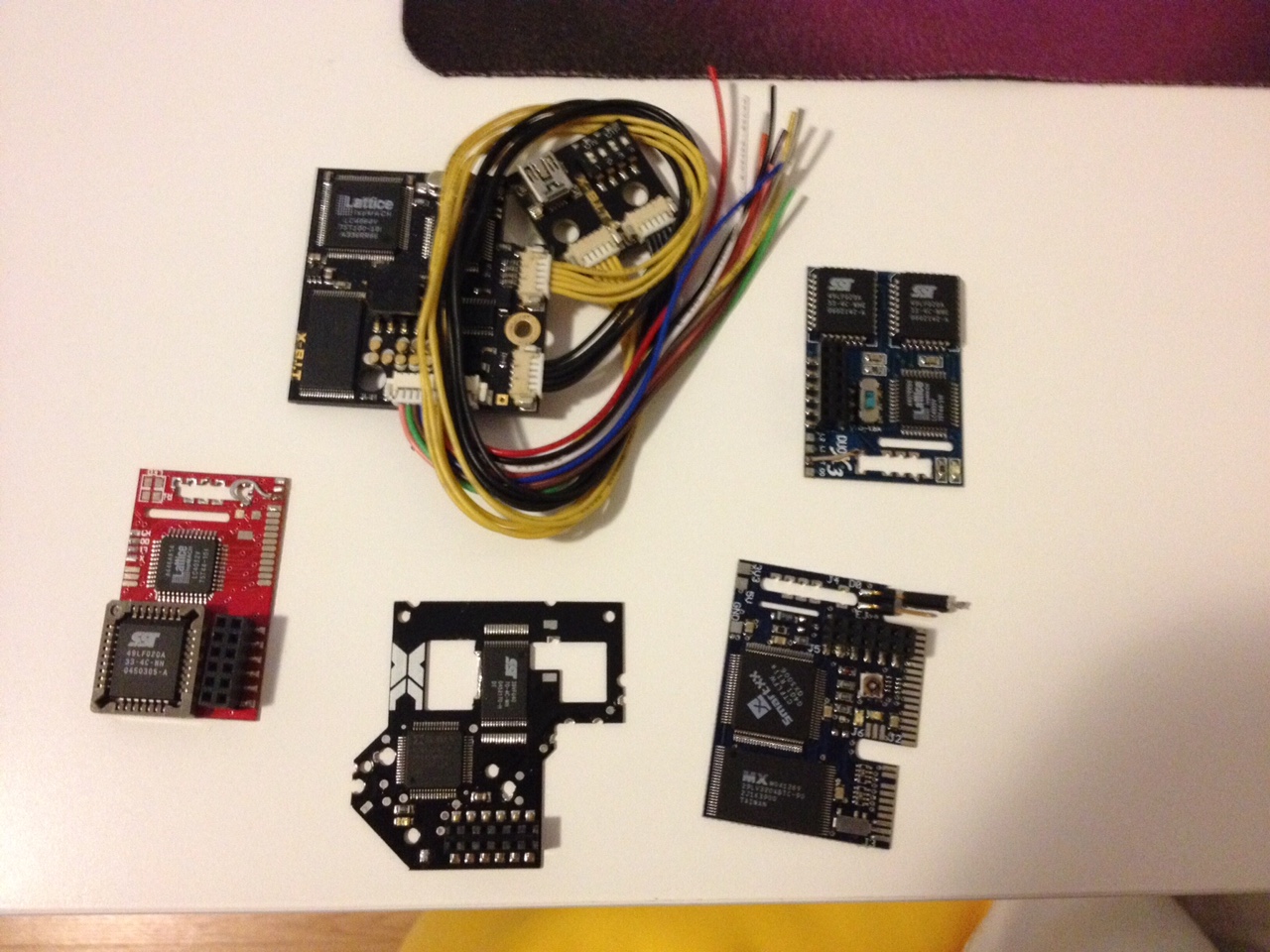

Here is my Xbox Modchip collection, also there are custom cables i made (a little bit offtopic, but i didnt want to open another post)
